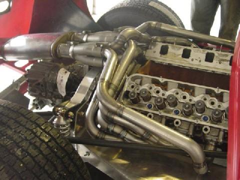

Here are some custom headers Fran had built to fit the Yates heads. The primaries are bigger which created other problems. They turned out fantastic. Fran is doing some quality work up there!
Dlampe is offline
