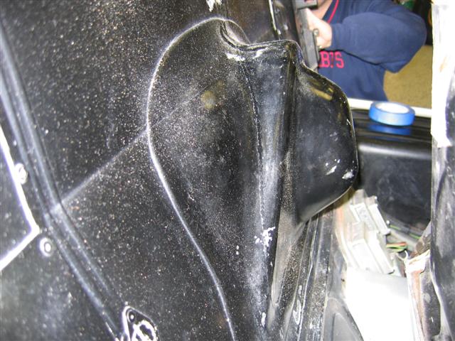

As the RCR40 is dimensionally correct in body and chassis size and shape a bump in the firewall is ALWAYS necessary....see attached pic of an original GT40....this is the most extreme version I have ever seen in an original but you get the point.
The SVO short pump is the pump that should be used in most all GT40 applications....the balancer does not create a problem as that is behind the seat back.
