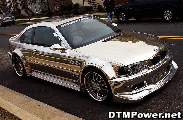

will be possible to have a finish as this one?
will be incredible on a GT40

FYI, this is the finish being referred to (by Paolo):
Alsa Corp | ChromeFX: Product Information-Our Chrome FX can produce a real METALLIC FINISH on any surface

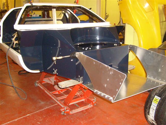

Blue black....very cool colour...

Now I'm really drooling! I hear the clock ticking...I can almost hear the phone ringing...any day now...looks fantastic, Fran!

Is that the Blue Black you insisted on me ordering?

YES.....
