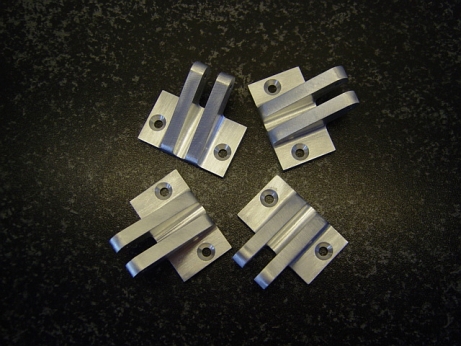

It depends on which latches you have.
I have attached a sketch (I think from ERA) and a photo of the brackets to give you the general idea of how the original types were assembled.
On original cars the fixing screws passed sideways through the box section which I believe might be a stronger fit.

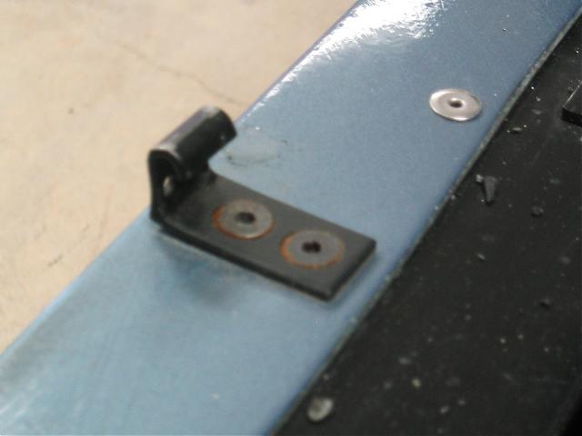

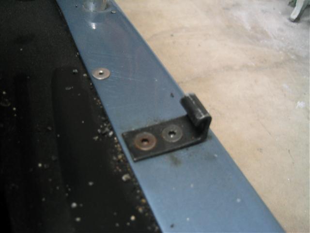

I'll try to get a few pictures of mine for you later today. Are you using the latches from Pegasus? If so,you have to weld on a 90 deg tab to the part that attaches to the chassis.No big deal though.

Sorry it took so long Dean.
Here you go......

Thats not how I would have done it but i will now. Good job!
