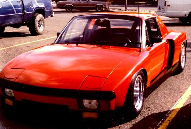

As a teenager I built a 914 V8 Porsche, I spent every spare penny to build it, in the end it was a very cool car for a kid, but it did have some shortcomings only money could have solved. I vowed someday I'd make up for those shortcomings. My last visit to RCR was the start of that endeavor.

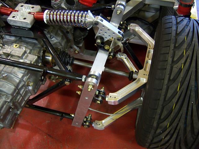

Even though I own one I'd never actually seen an SLC in one piece in person, until today. Of course I am probably not the most objective guy on the planet when it comes to the SLC but, wow. RCR is doing a great job thinking through all the little details that only comes through experince.
The Ricardo transaxle isnt as big as it looks in pictures but it certainly looks like it will do the business and it takes 930 CVs. Fran has also found a reliable supply of custom order halfshafts. Yeah.
I must say I am a happy guy, as others have said the car looks great in person and I'd have to agree, the suspension is almost to nice to cover up with bodywork. Enpugh drivelling..I need some sleep, I'll post some pics when I get back home if any are worth posting.

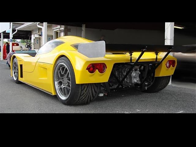

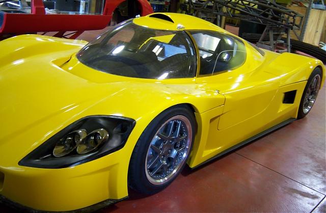

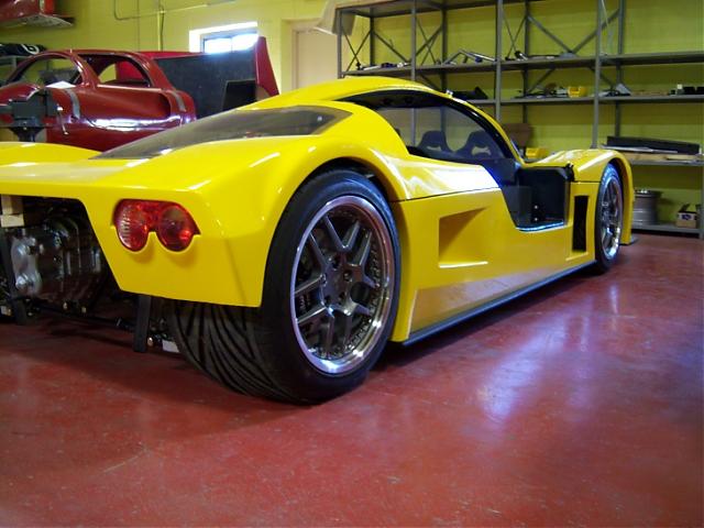

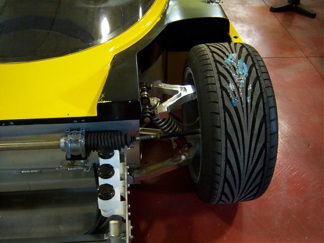

So a little clarity is in order. I had some business to tend to in Florida and it just so happened Detroit was in the flight path (not) :-) I went and saw the yellow car that many here have already seen (the prototype chassis) . My chassis was off serving ''production body mold fitment'' duty so I didn't get to see that. The yellow body was just a pre production quickie for the Carlisle show, the production body will have a number of refinements (smoothing of the hidden areas, latch and hinge clearances, ect) . Remember I had never seen the car before and to say its more impressive in person would go without saying. Here are a few shots that are similar to others seen here before. The yellow car is just about ready to move under its own power .... that will be cool.
