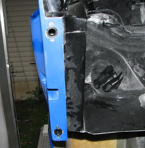

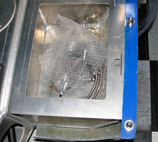

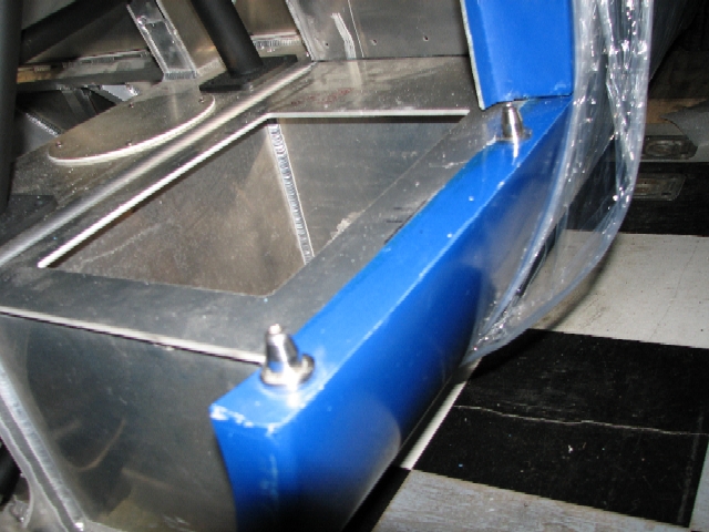

Does anyone have some pictures on how the clip locator pins are installed? I need to send them to my painter so he does them correctly.

Not in the build manual. The painter needs to see where they go and their orientation

OK, I found a couple of pictures that show the pins mounted. The male pin is mounted to the chassis, but is a hole cut on the body so that the pin rests on the chassis?
I can't find any pictures of the the mating side and it's mounting and orientation.

Bill - I'll try and remember to take a snapshot of how mine were mounted by the boys at RCR.

Great! That would help considerable. Need both the male and female mounts

Here are some resized pics of mine - I emailed the originals to you Bill!
