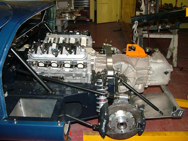

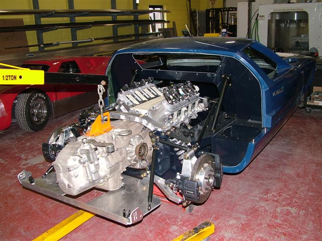

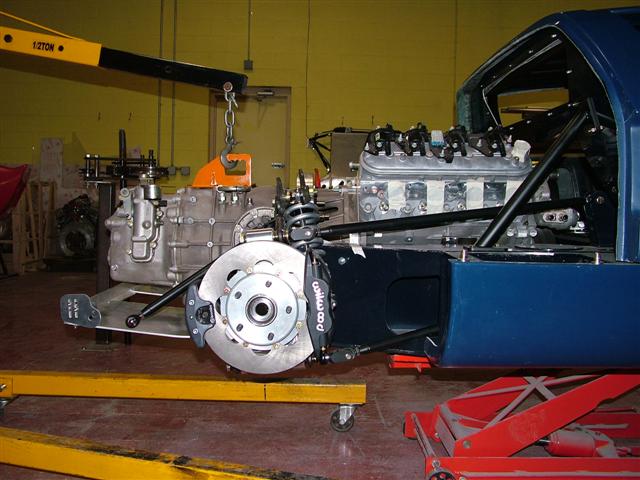

Here are a few pics of the LSx and Ricardo box .....its a tight fit but it does fit all the same.

Non really.....we made a new adapter plate for the Superlite Coupe..LS7 TO Ricardo and just decided to try and drop it in the back of the RCR40....voila.
The rear undertray will be notched but we do that for the various transaxles as a matter of course...
I have always had an eye on the Ricardo transaxle as its the only new high volume OEM transaxle solution for big 700hp plus performance applications in the last 30 years...

I forgot to mention that with the our new custom flywheels..stock Ford GT clutch and starter are retained, making service easy too.
