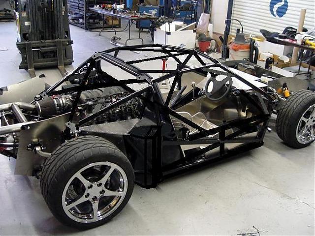

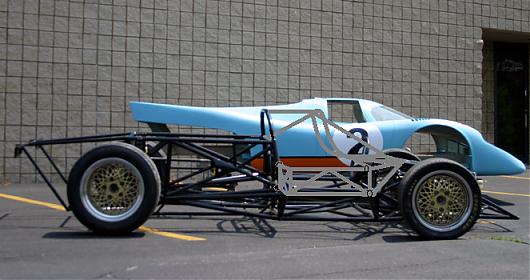

I second what Randy has said. I am putting together a Lola for SCCA SP classes and the cage design took some work. It meets the specs easily, but a lot of thought went into the design (not my doing, I had my tech inspector and a good cage fabricator do this work). The open nature of the Spider helped out with making the cage easy. The small enclosed nature of the 917 will make it harder, but a cool project!

Thanks for the input guys. I have read the rules and for every car I'm interested in, those include all of Frans cars and the GTM, the first thing I do is design a roll cage based on those rules and all other safety considerations. The reason I like those classes is you can have your cake (917) and race it too.
Stay in touch guys as you are presently doing it, I still in the planning stage.
Jack
I think I attached two photos or files. We'll see!
