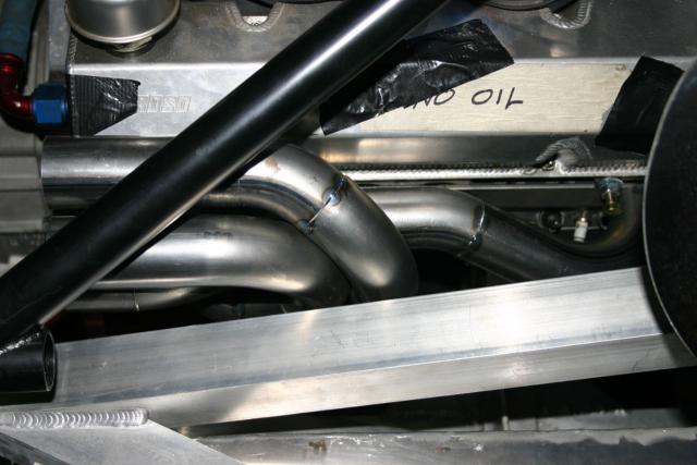

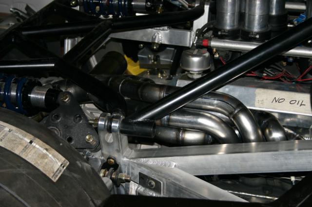

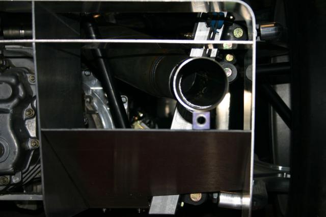

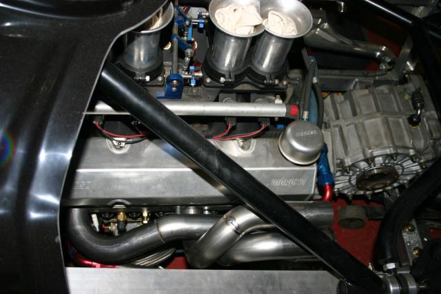

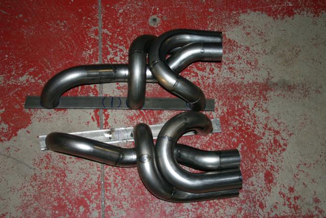

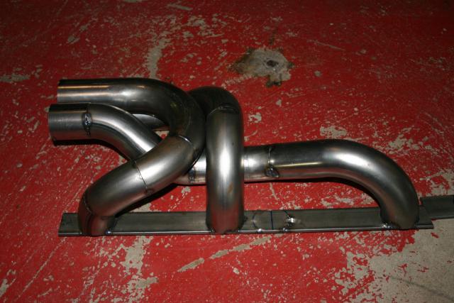

As promised here are the photos of the headers that I spoke of.

Re: Small Block Chevy RCR Superlite Headers
Excellent job Denny, especially considering that the dry sump 4 stage drive is on the drivers side of the engine. Getting that last tube in is always a pain though isn't it?
The spart plug locations on the 18 deg heads create trouble too.....otherwise the headers would be running downwards, and not upswept...
easier packaging downwards..
After making my own headers for the GT40 I have great respect for your workmanship on these headers. It took me more than four hours per tube to cut, fit and tack each one together.

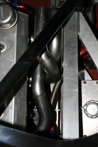

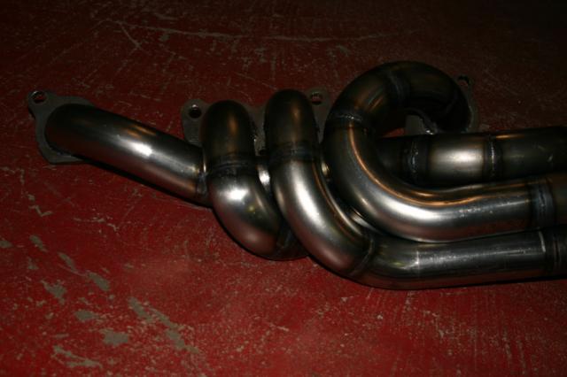

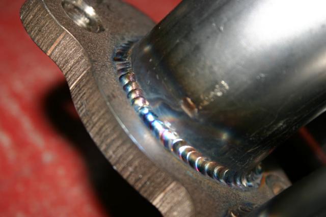

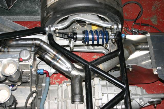

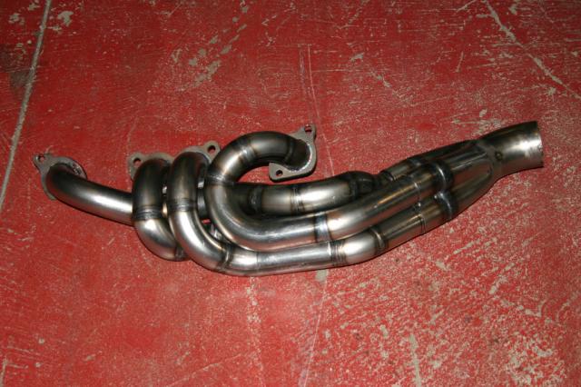

Here are the photos I promised... Have a look.

They will be screamers for sure......these are on a car that will also be the R 'n' G
