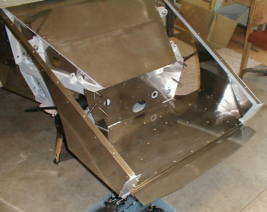

Try this

Please excuse the dirt

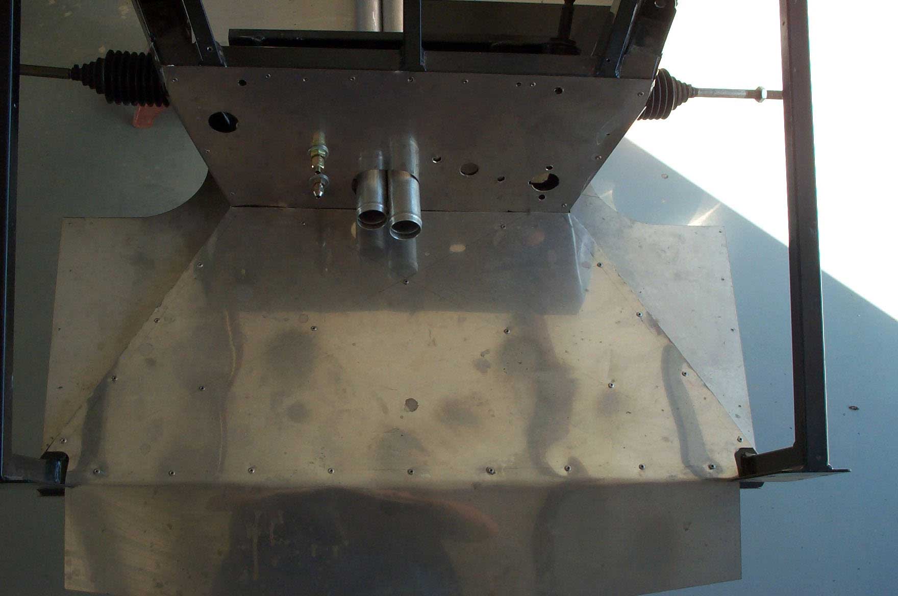

Hi all, I just made my tray today and just installed it. I did make the channel and the front "tab" is straight out for now. I guess if I need to bend it further down later I can . Dan

The tray looks good Dan. You're right about the bend.
You can do that at anytime. It only has to be bent down enough to contact the lower lip on the front clip.
