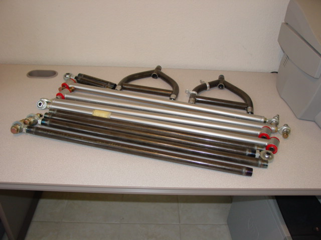

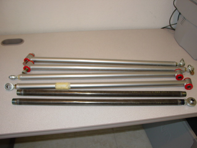

I have some 4130 links made up for the rear of a RF 40 (heim jointed). If your interested PM me and we can talk. left and Right joints so the adjustment is just like a tie rod. My originals are 30 and 29 1/8 (Centerline of the forward mount to the centerline of the heim).
Name:	Rear Arms 001.jpg
ID:	15010   Click image for larger version
Name:	Rear Arms 002.jpg

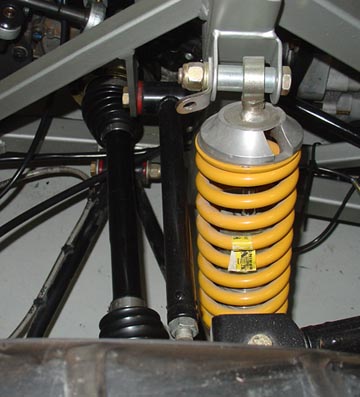

my upper trailing arms are about 28-1/4 inches long. This is using a tape measure with the little grabber not centered on the bolted joint, but to the end of the bolted joint (the one that connects to the chassis). My upper arms from chassis to upper hub face forward. I'll snap some pictures and post them.
patbarry is offline
Old 09-01-06, 10:21 PM   #9 (permalink)
patbarry's Avatar
Gold Supporter
Join Date: Apr 2002
GT40: Houston, Texas
Posts: 678
photo attached herein
