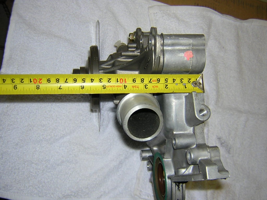

Maybe a little visual can help. [img]/ubbthreads/images/graemlins/grin.gif[/img]

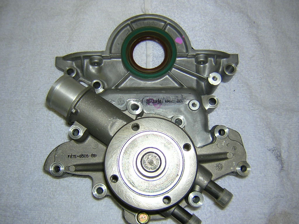

another

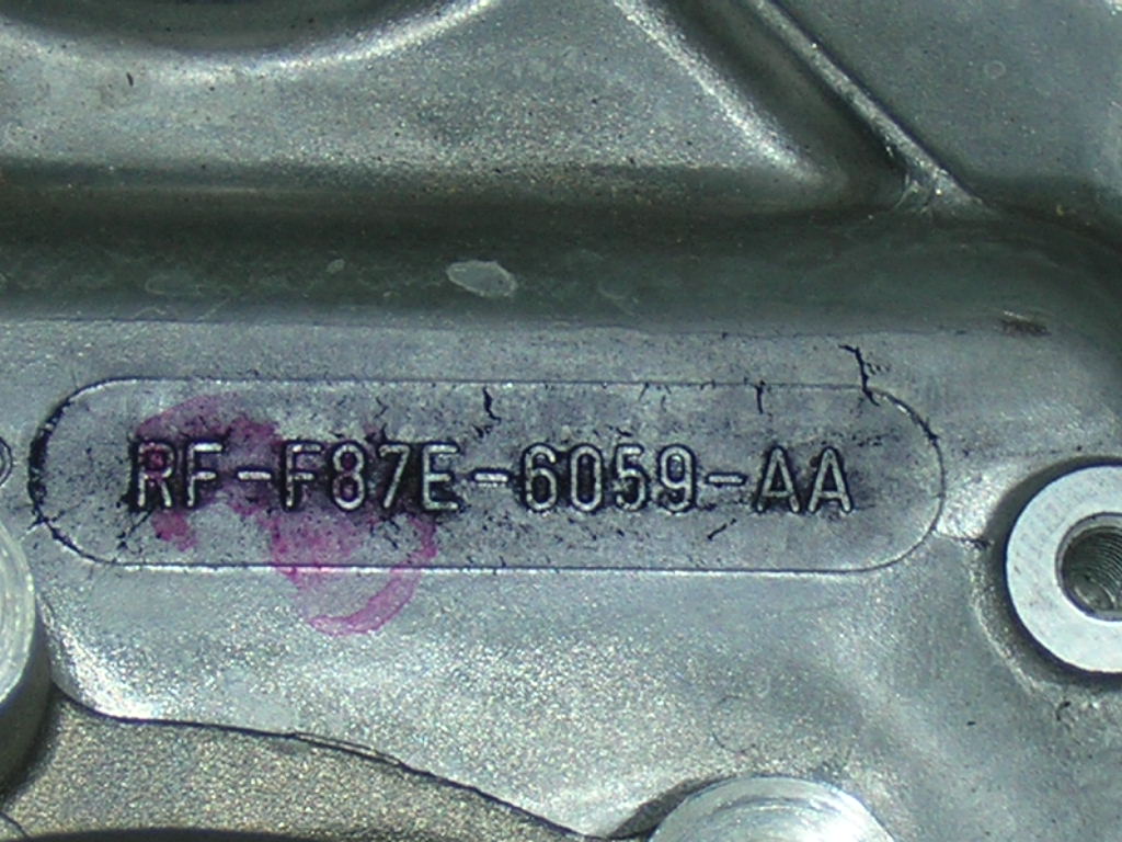

one more

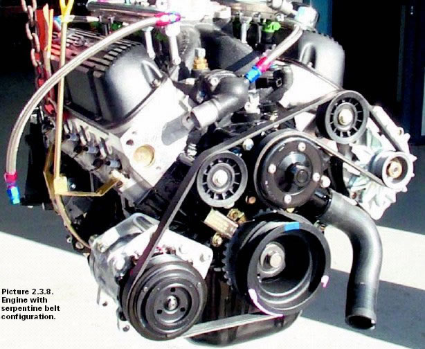

After looking back at the 2005 catalog , I think the correct numbers would be M-8501-A50 for the cover and pump, and just M-8501-D50 for just the pump.I realize there are numbers on the castings, but I think that may be the same units ? That or they are no longer in the motor sports catalog. Maybe Hersh can take a look and confirm , that way the next guy can use this info. [img]/ubbthreads/images/graemlins/grin.gif[/img] Dave here is a shot of RFs serpentine setup, looks like you would have to do more than just use a shorter belt, due to you wouldnt have enough of a wrap on the crank pulley.Photo courtesy of Roaring Forties
