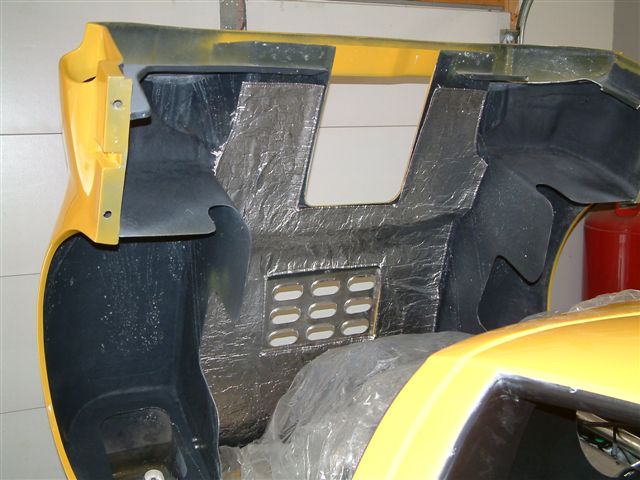

how does one attach the insulation material to the underside of the rear clip? Will the sikaflex hold up with the heat?

We use "contact" adhesive on both the matting and the body and then once semi-cured put them together. The only time they have let go is when the under side of the body has not been keyed correctly (take the sheen off with a sanding disc and definately NO paint).
I hope this helps,
Best wishes,
Robert

Dynamat (dynamat.com) makes a material called "Hoodliner." It is especially designed to shield heat, reduce sound, and stick upside down in the high heat areas over the engine. The cost for Hoodliner, P/N 11905 is $70.00. The website has PDF spec sheets for each product.

Not to be distracted by the Motec stuff, Robert Logans' suggestion to use the contact adhesive worked very well. Hopefully the image uploaded.

Rolf, how is your heat blanket holding up? What contact cement did you use? I've been experimenting with several different glues and contact cements, and none seem to be able to withstand gasoline. Now, maybe I'm being anal, and I don't expect gasoline to actually contact the blanket, but just wondering about vapors over time, etc., etc., etc.
