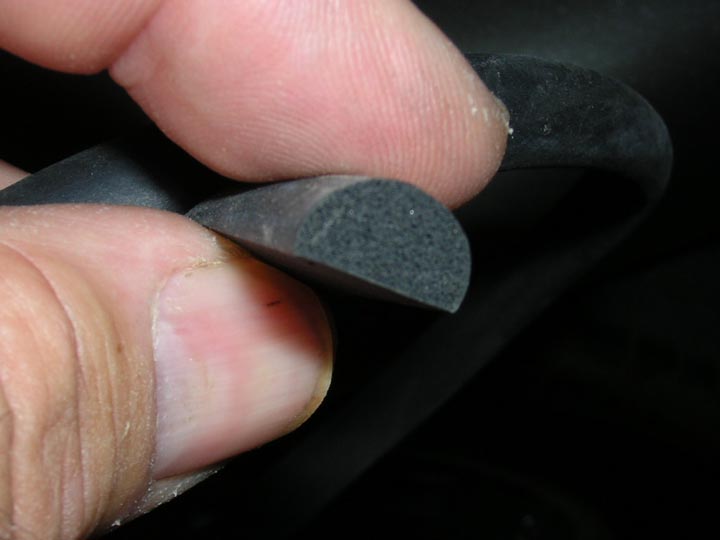

None of those methods work well in my opinion. I used a simple closed cell foam half round weather striping It was 1/2". You can buy it at any automotive trim supply shop. You will need about 10ft. I simply adhered it with clear silicone. It fits down into the half round tray of the spyder perfectly. The rear clips edge sits on top of the foam and makes a great seal.

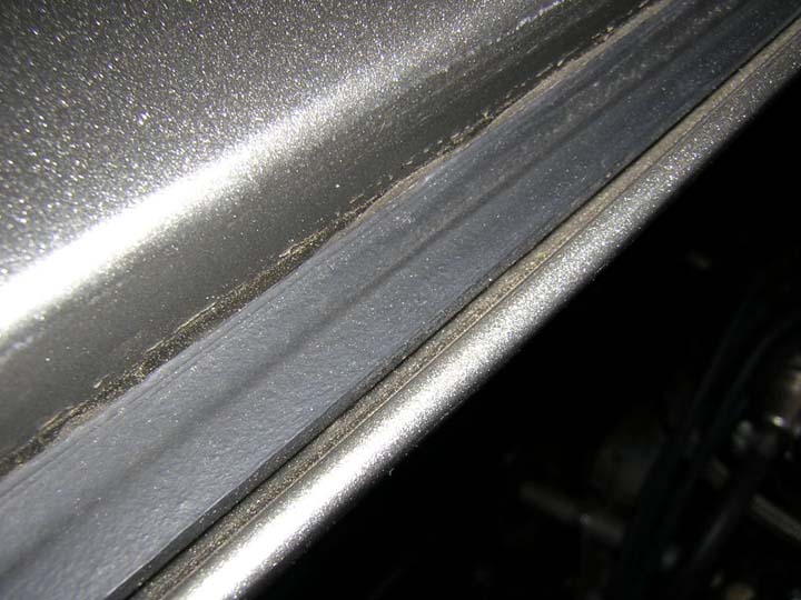

That seems like a good solution. Could you post a picture of how yours is done? I thought that the door weather stripping was to big, but because there was so much of it that came with my car I thought that it had to go there. I'll look around for some of the 1/2" foam you suggested. I bet Soft Seal make something I can use.

Here are a few photos for you...

another...
