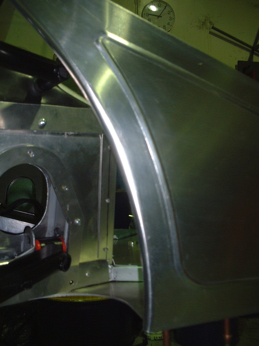

found this , one of the panels I made .
Put a radiused edge of about 10mm to give it strength.
Jim
