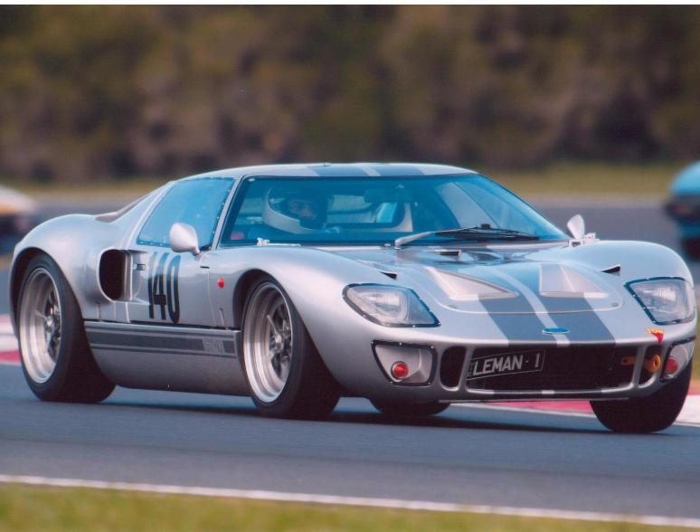

Just as a foot note to the aerodynamics at 240kmh. My front clip hinges are located higher than RF intended. The result was that whenever the front clip was raised, the nose of the clip would foul the short section of panel that lives between the lower edge of the nose and the leading lower edge of the space frame. The quick solution was to simply remove that panel until I could come up with a more permanent solution. Consequently some air is now being deflected off the radiator and under the car. I know that this has a noticeable effect at 240kmh because I lost my number plate (that was mounted just ahead of the radiator and also angled down) half way through the day and a significant improvement was noticed. Here is a pic of the car just before I lost the number plate.
