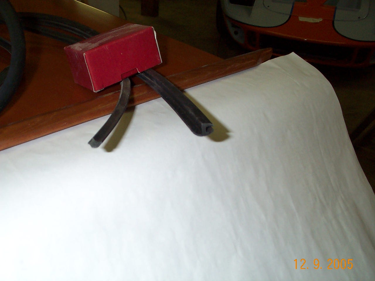

I can live with the inside frame as mine is also painted and with the roll cage you can't really see much except above the mirror. I have 6.5' of the one on the left and have no idea where it goes and 10.4' of the one on the right which I believe fits around the back glass. I have searced the internet and can't seem to find anything like the one for the back glass.
Simon

The rubber on the left is the capping rubber used on the inside over the fibreglass in the front screen surround if you can get to fit. The other is the actual glass rubber. From memory same type rubber fits front and rear clip glass. Sounds like you may not have enough of the rubber on the right to complete the instal? (front and rear glass)

Andrew, the one on the left is not long enough to go around the front window, about 3 ft. short. I think I can find something to finish out the inside . The only visible area is where the windshield meets the dash. I have search the internet many times and cant seem to find any thing like the one for the back window. I really don't want to just caulk this seam between the glass & the body.

The upper left photos is the trim piece that goes over the fiberglass edge of the windshield opening. It's a staple shaped profile. It does not go all the way around the winshield. It starts at the lower A-pillar then goes up and over the top then terminates at the other A-pillar. You do not need this on the lower adge as the dash covers this area.
The upper left photo is the rear bulkhead glass seal with the locking strip placed in it's grove on the seal. This locking strip is what I think you have in you in your photo.
The lower photo is the windshield and the rear glass seal.

Hersh, that's the one on the bottom, also the one on top left. If you can fix me up I would really appreciate it and be more than happy to pay you for it.
