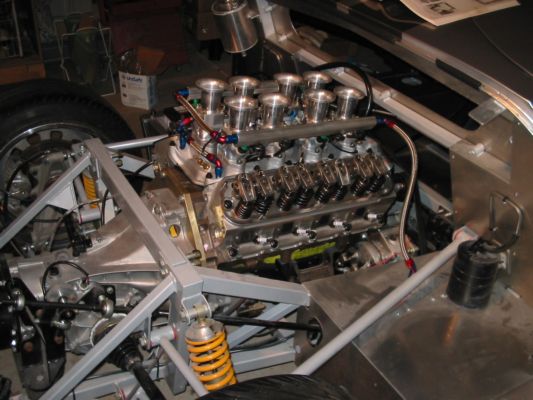

This is the best picture I have with exhuast removed. You can just make out that the drive shafts are in a forward facing V.
If you need an acurate messurement, I think a good place to messure would be from the adapter-plate to the chassis top cross member. My car is away getting some work done at the moment but I can messure it for you when I get it back.

Thanks for the pictures. Seems like they all are that way so I guess I'll call it good!
