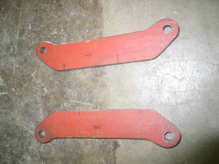

But i'm making them myself i'll post a picture

still working on it but this is the beginning

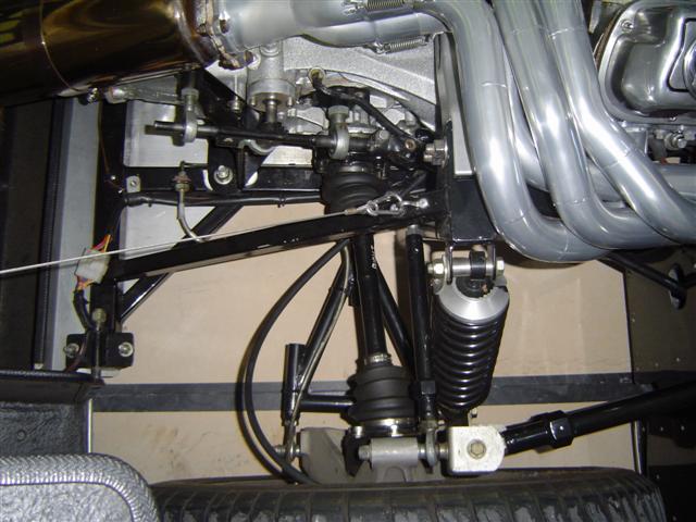

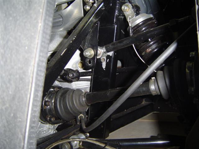

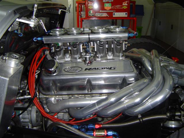

Ross,
Drive shaft angles are not too bad. I have not measured the angle but they look ok with travel still available in the CV's.
My rear end (the car that is) is set up fairly stiff to counter understeer issues so there is inherently minimal rear suspension movement.
Attached photos show : Engine as level as I could get it, Drive shaft looking down on it, and, Drive shaft looking from as far behind as I could get with the rear clip in place.
