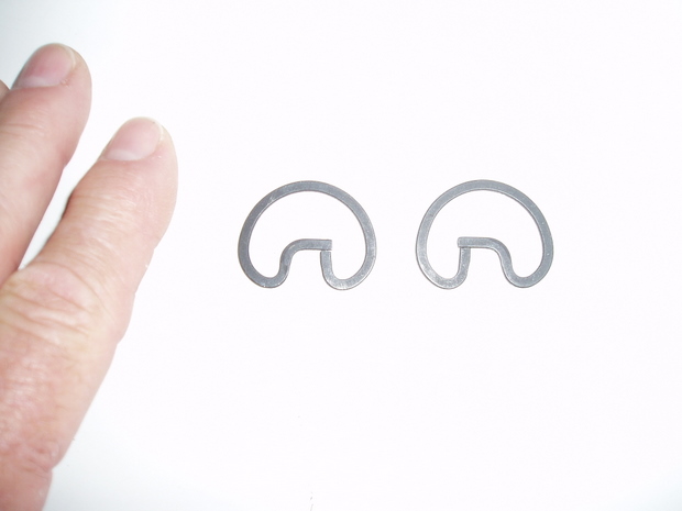

I have 2 circlips left from my build. Is anyone familiar with where they belong. They look like retaining clips for a u-joint, but I haven't a clue where I omitted them.

Do one end of your U-joints fit a captive yoke with U-bolts or retainer straps in which case these would not be reqd. Corvette C4 outer U-Joints are like that. If thats the case you should have 4 clips over.

Thanks for your reply Jac Mac. The RF has CV joints not u-joints so I'm still lost. I do wonder If the new owners of RF come on line and if so - HELP PLEASE!!

They come out of your propshaft....you have fitted your propshaft haven't you?

Sorry Simon, I don't know the term "propshaft" on cars only on ships. I have fitted everything except these clips and driven 2,500 miles.

Hi Jim, That is some extra hardware RL gave you to make up for all the wrong hardware RL gave you and made you source it all on your own. LOL Take care bud, Dan

The only place on an RF that has retaining circlip like those is in the master cylinders to retain the piston\link rods to the pedal box at rest. As your car is completed an running possibly like Dan suggested bonus parts?

If you have done 2,500 miles with no drama I would relax and put them in the extra category also.

I don't recognise that part at all from our kits, I think the ideas of extras and spares may be correct.
