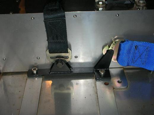

I made up these brackets so that I could use both the lap sash and the harness style belts. I had them approved by the engineer working on my car. They took a bit of work but seem to work well.

Trevor I may not have been clear.
The seat mounts on the RF are the strips off steel that run across the floor for the seat to mount to not on the seat itself.
I know Bob has an RF and the seats are made of glass and bolts direct to the strips.
A angle bracket as per Peters pic mounted to the strips.
Sorry if I confused you Bob.

Thanks to all that replied. As I"ll be using both types of belts, I may need to use a bracket similar to Hilly's to provide all mounting points. Just need to check with engeneer.

The REAR floor strap should be used for the lap/sash seat belt. Thats the one that the seat does NOT bolt to. (Lap/sash seat belts are designed to mount rearward of the driver's lap).
The harness on the other hand bolts to the same strap as the rear of the seat. This results in the lap strap taking a far more verticle path to the driver's lap when tightened. One reason is to stop the lap strap from rising when you tighten the shoulder straps.

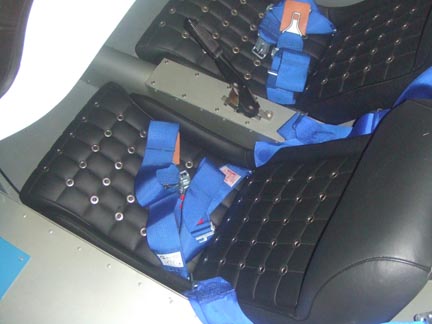

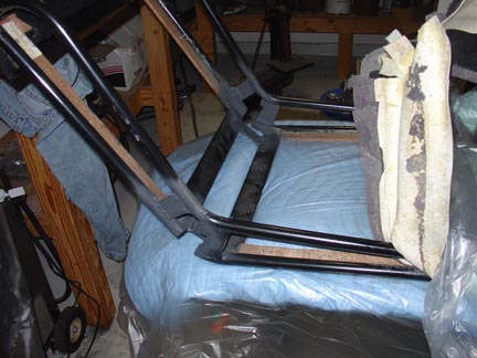

for what it's worth, I cut the seats, welded on a brace to use 5 point harness. Seats look unchanged after they have been put back together.
