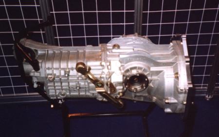

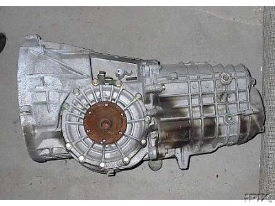

Brett said that Ultima use the Getrag from Porsche Boxster S, but the pictures of one for sale
Boxster S on ebay
do not look like the ones lined up at Ultima
Ultima Getrags
or the one Julian West photographed on the Ultima Stand
and not like an 01E
O1E box
The ones at Ultima appear to look like the Type 450 pictured on Getrags website
Getrag page
I spoke to Ultima who have told me the Getrag box they use is from the 996 (but didn't say which 996), but that is not listed on Getrags website, or is 996 just latest incarnation of 911, hence why the Ultima ones look so similar to the Type 450, listed as for 911. Ultima also told me that this is invertable (like Julian saw) just like the G50 (their other option) using same mountings but different brackets.

Picture of Boxster S box on ebay
