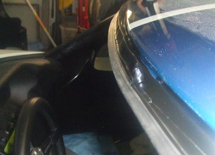

I am not an expert, but the guys who just did mine said they did not recommend using sealant only. They tossed out the rubber supplied and did a three step process, 1) a rubber trim piece around the fiberglass (very thin), then a primer followed by Dow "Betaseal U-418HV)" urethane adhesive and then the rubber. All taped off right now, they suggested 48 hours to leave the tape on. They said this was the same stuff used by OEM.
For what it's worth...
