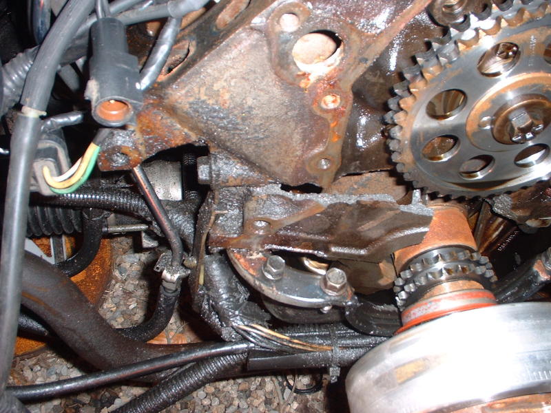

Sorry, Ian, but that's incorrect; the small-block Ford was not designed for high-rev operation. The stock 302 block uses two-bolt main bearing caps, and I can guarantee it will not live long at 8,000 rpm, even with a stud girdle and a built lower end. Here are some photos of a SBF block failure attributed to over-revving and a stock balancer:
