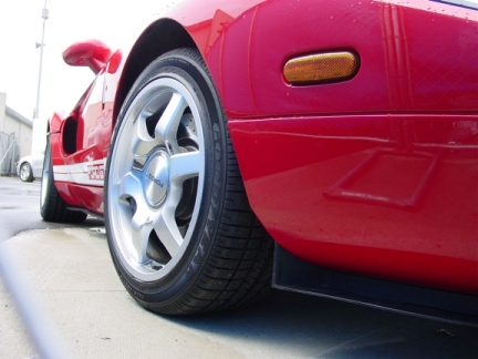

You can just see it in this picture I took at Indy twoo weeks ago. This one cruised downtown Indy later that Saturday afternoon and then Jackie Stewart drove it Sunday morning.
