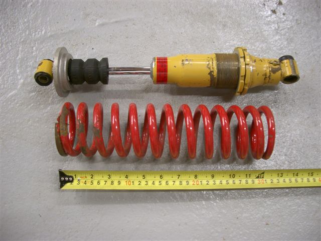

FWIW, here is the damper & spring from the rear of my stock GTD.
The damper is pulled out to the end of it's stroke.
Hope this helps.... /ubbthreads/images/graemlins/smile.gif

Julian, I was just about to take a shock off my GTD but I see you have one apart. If you would, could you post the following dimenions.
Center of top shock mounting hole to center of bottom hole fully extended.
Same as above except fully compressed.
Top spring perch face to bottom spring perch face with bottom perch set to minium ride height as in picture.
Lenght of spring, free of load, off shock.
Thanks, I will need to replace mine. 3 out of 4 have blown all the oil out. I have the same spaxs as you do. I think I will going to Koni's.
Thanks, Howard Jones

Measurments as requested, (to within 5mm or so /ubbthreads/images/graemlins/smirk.gif)
Center of top shock mounting hole to center of bottom hole fully extended = 375mm
Same as above except fully compressed = 295mm
Top spring perch face to bottom spring perch face with bottom perch set to minium ride height as in picture = 260mm (fully extended)
Lenght of spring, free of load, off shock = 300mm
Hope this helps!
