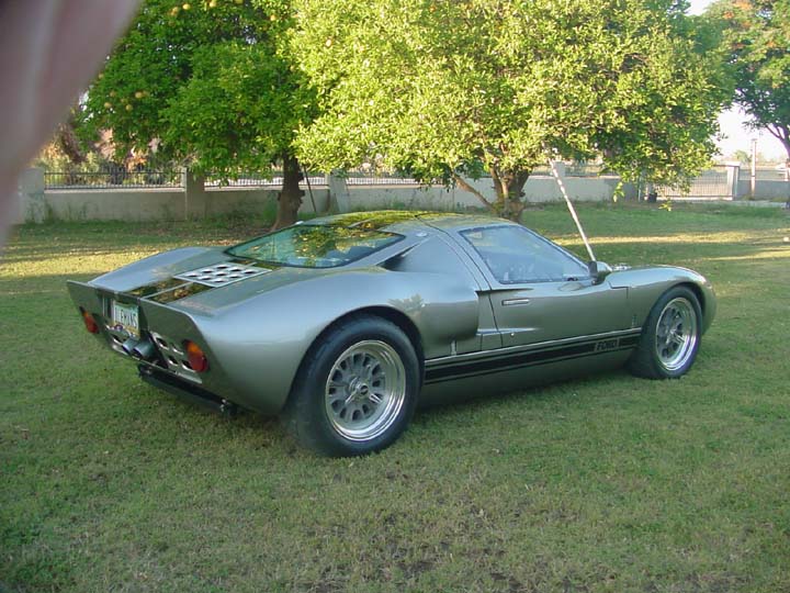

Well now, to start with I just finished installing an Audi 3U trans in the GT. I wanted to get a few miles on it before I posted the results. When I had the 5N trans in my GT the RPM's were 3600 at 75MPH. Now it's much better, at 75MPH I'm only turning 2800 RPM's. I can live with this!
The first gear is virtually the same as the 5N trans but the other gears are all a little taller and I like it!.
The GT now is a lot quieter on road trips and my motor is not going to wear out as fast. /ubbthreads/images/graemlins/grin.gif
Sorry folk but I have no idea why the photo didn't print but here it is...
