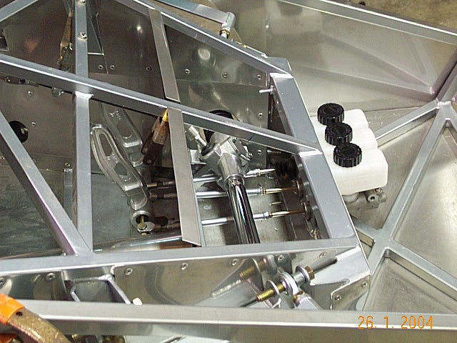

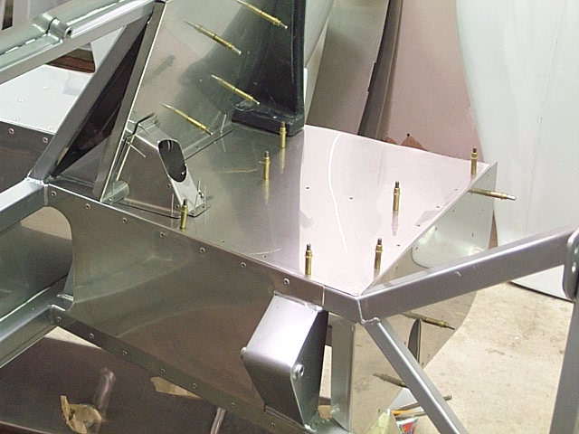

Have been realy busy with work but have most of the paneling done along with steering rack and pedals.
Thanks Hersh,Wish I had more time right now but it's coming along. Next will be brakes & rotors, Wilwood 6 piston up front & 4 piston on rear. I'm also thinking of using a 930 turbo box unless someone can tell me why I should't. How do you like your new trans?
Simon
Simon,
The 3U trans is working good. I like the ratios alot. With the .64 5th gear it keeps the RPMs around 2600 at 75MPH.
As far as I know the G50/52 box is good and takes alot of power so you should be OK with it.

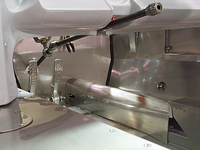

Looks great! I like that pedal and master cylinder setup. Did RF set up you chassis for that brake system or did you adapt it? Would you mind providing part numbers?
