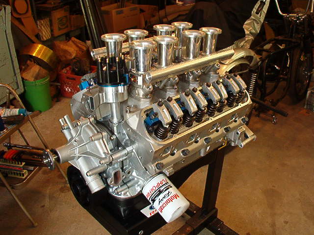

Hi Lynn, I would like an answer also as I have those heads sitting on the self, new and also with a high dollar CNC port job done to them. When I built the engine for my CAV, I used stock port location Edelbrock Performer RPM heads. /ubbthreads/images/graemlins/smile.gif
Here is aq pic of my engine with the Edelbrock heads
Vic

Victor,
What a gorgeous engine!!

Victor, that IS a great looking motor you built. Is that an aluminum block 302 Ford? How much power does that make, and what does it weigh?
Hi Jim, No the block is not Aluminum! I wanted the engine not to be multi-colored. I always paint my oil pans semi or flat black as I believe the heat is transfered to the air better. Thus I didn't want a Blue Block, black pan and Alum for the rest of the engine. The paint is Dupli-Color High Temp Alum over hand brushed Rustoleom with a Hi-Temp Clear. The block was deburred and smoothed inside and out.
The block is a new roller explorer unit filled with the best parts I could find, Boss 302 steel crank, H-beam rods,Hipertech pistons and a Comp cam.
Similar engines I have built make about 400 to 420 HP with a Speed Demon carb. I am anxious to put this one on the Chassis Dyno soon after I get the bugs worked out so I can see if the Fuel Injection was worth the cost and the installation.
Vic
CAV 40
I don't think the exterior color of the pan has any effect on heat retention. It would absorb radiant heat from the sun better than white, but this is not a case of heat absorbtion.
Nice looking motor.
I read some time ago in one of the Hotrod type mags the reason Radiators and oil coolers are painted black for heat dissipation. As I recall the writer or the articale also stated not to paint brake drums as the paint held in the heat, but if you must a flat black was his recommendation.
Vic CAV 40
