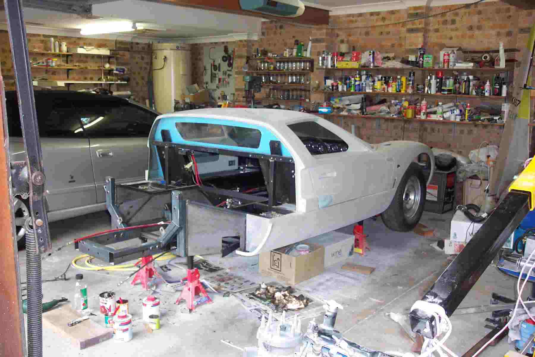

I thought that it was about time that I posted some info & pics of progress to date. Some history :
I bought the car from a DRB dealer about 30 months ago - a previous owner had started (engine, trans, suspension roughed in) but ran out of time. He ended up buying the dealer's own completed car & as part of the package, gave the dealer back ol' #027.
This sat in the dealer's factory for a year or so until I rang them to ask what sort of lead-time would apply for delivery of a rolling chassis - the answer was "About 5 minutes - we have one sitting here for sale" ! After picking myself up off the floor, I told them that I would have to sell my '89 Corvette to raise the funds, so I couldn't do anything immediately. The dealer said "An 89 Vette - I've been looking for one of those" - at that point, I felt the hook sink in !!
The dealer (DC&O) make 8-stack inlet manifolds & throttle bodies for SB Fords (used on most Oz-built EFI GT40's) & was looking for a test-bed for the GM version. Two weeks later, I drove the 'Vette down to DC&O and came back in a tilt-tray truck with the '40 on the back - a straight swap !
Two & a half years later, it is nearly finished & I am struggling with the bureaucratic nightmare associated with getting it registered - about the only bloody thing they don't want is a crash test !!
I'll try to post some progressive pics & comments, starting with the "raw material", through to the present time.
This first pic shows the car pretty much as I got it, but with lights, latches, etc roughed in :

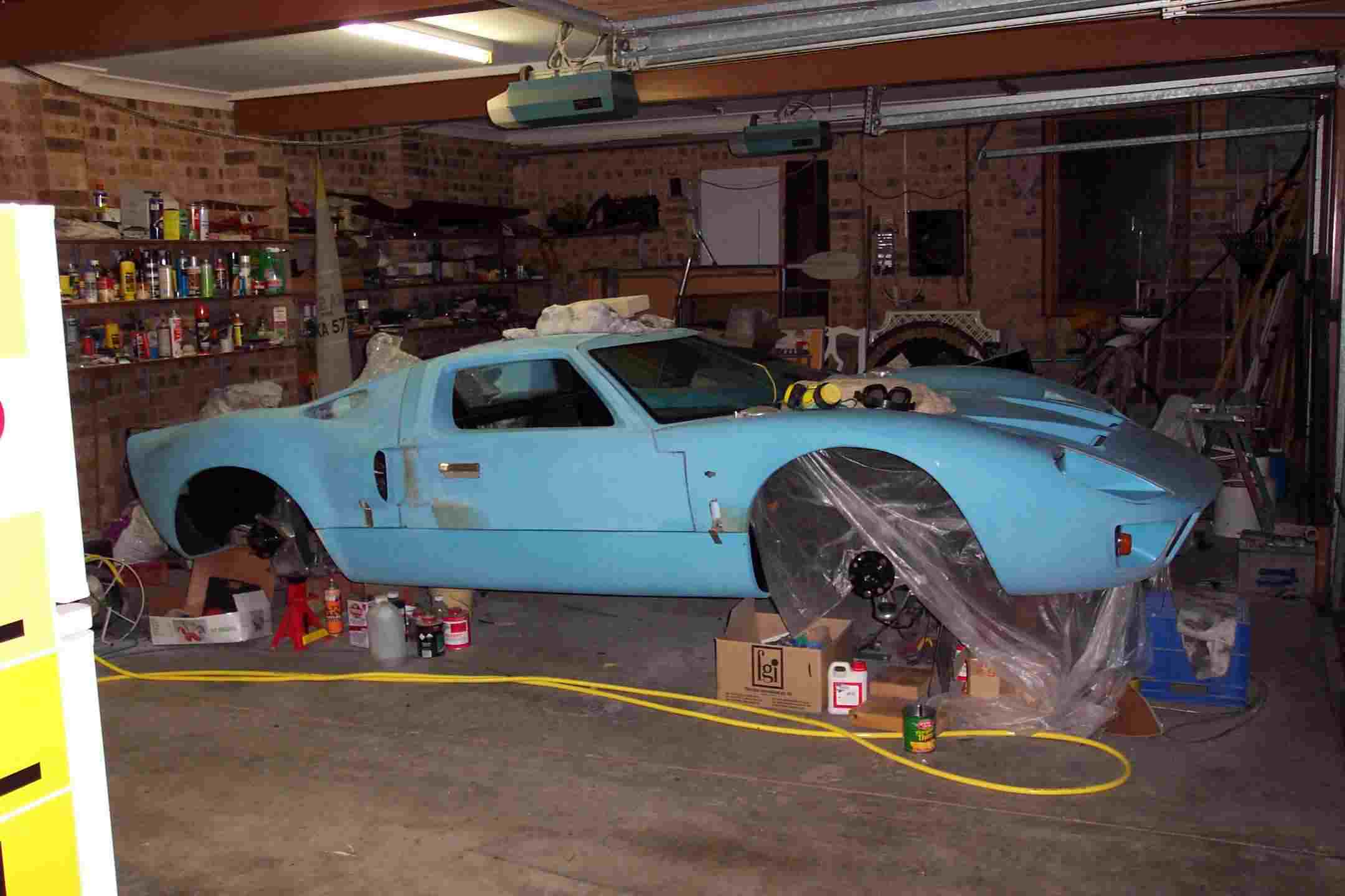

This next pic shows the engine bay with most components test-fitted - note the rust everywhere !
Peter Delaney
At this stage, I have most of the body prep done - there is about 10metres of chopped-strand-mat over various parts in order to get panel gaps & curvature right (& about 6 months of glassing/sanding/glassing/sanding) !!
The previous owner had kindly covered the whole of the inside front & engine bay with bitumen paint - this took some 2 months to fully remove so that "real" paint could be laid on (this was not a fun time - permanently black hands & clothes, & a wife nearly ready to have me certified) !!

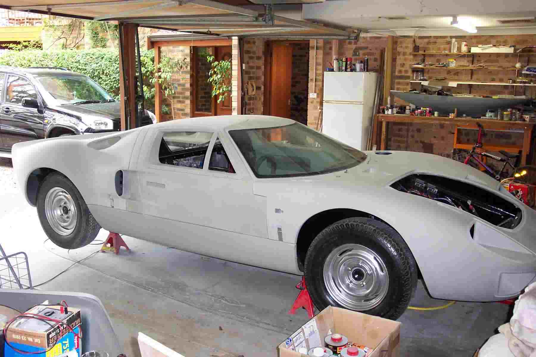

Nearly all the body-work is finished here - I didn't like the idea of "eyebrows" pushing the door tops down in the centre of the roof, so decided to "fix that". Six months later, I had reglassed & machined back the underside edges of the door tops, tilted the doors inwards about 5deg, built up the outer parts of the door tops & leading frame edges, & fixed all the scoop alignments. Eyebrows would have been much simpler !
This pic shows the car after all this & painted with grey Spies Hecker "Raderal" - a spray polyester resin filler that looks after pin-holes & provides a nice even base for the final flat-stick sanding.

This pic shows the car in the final Spies Hecker "Vario" primer, after flat-stick sanding ("blocking back" in Oz-speak)down to 400 grade dry.
Simmons FR17 wheels have finally arrived, along with Falken tyres.
Most of the wiring has been done by this stage, with the dash completed via a set of plug/sockets so it could be easily removed for the final body painting (& afterwards if required). Ready for painting - at last !

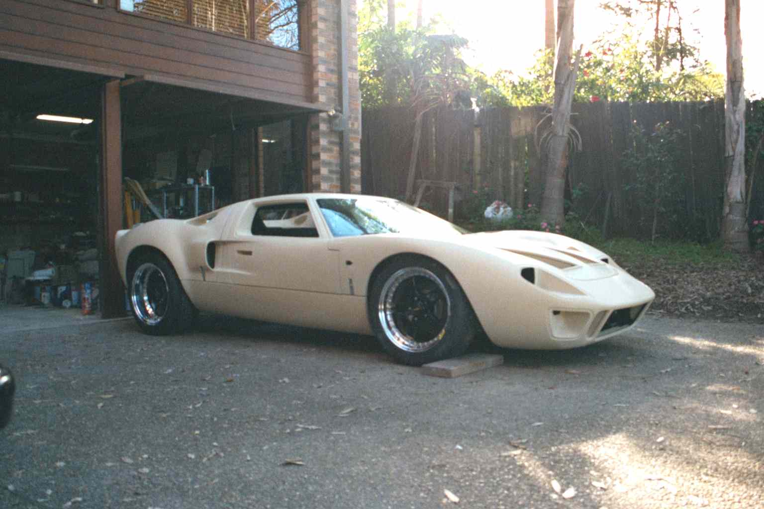

After doing the polyester resin filler & the primer, I decided that the 2-pack clear-over-base was going to be out of my league, so the car went off to a professional. "Not too bad a job for an amateur" he says - then we go on to run a guide coat over the car & spend 70 hours filling over 200 small defects that this revealed ! After touch-ups with the primer & a final smooth-over with 800 grade dry, we hit the painting - Scott did the spraying & I did the paint mixing / gun cleaning, etc. 12 hours later, we had 4 coats of base colour & 4 coats of clear on.
At this point, I was so glad that I didn't try to do the final paint myself !

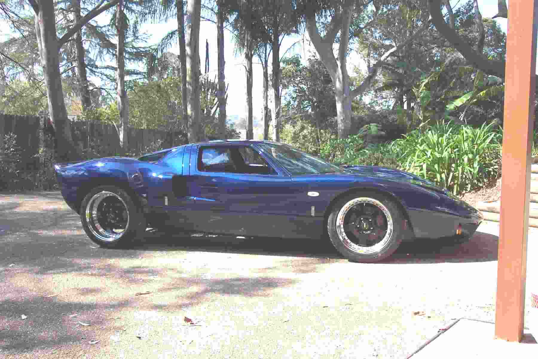

This pic is just after painting, with some of the lights, latches back on :

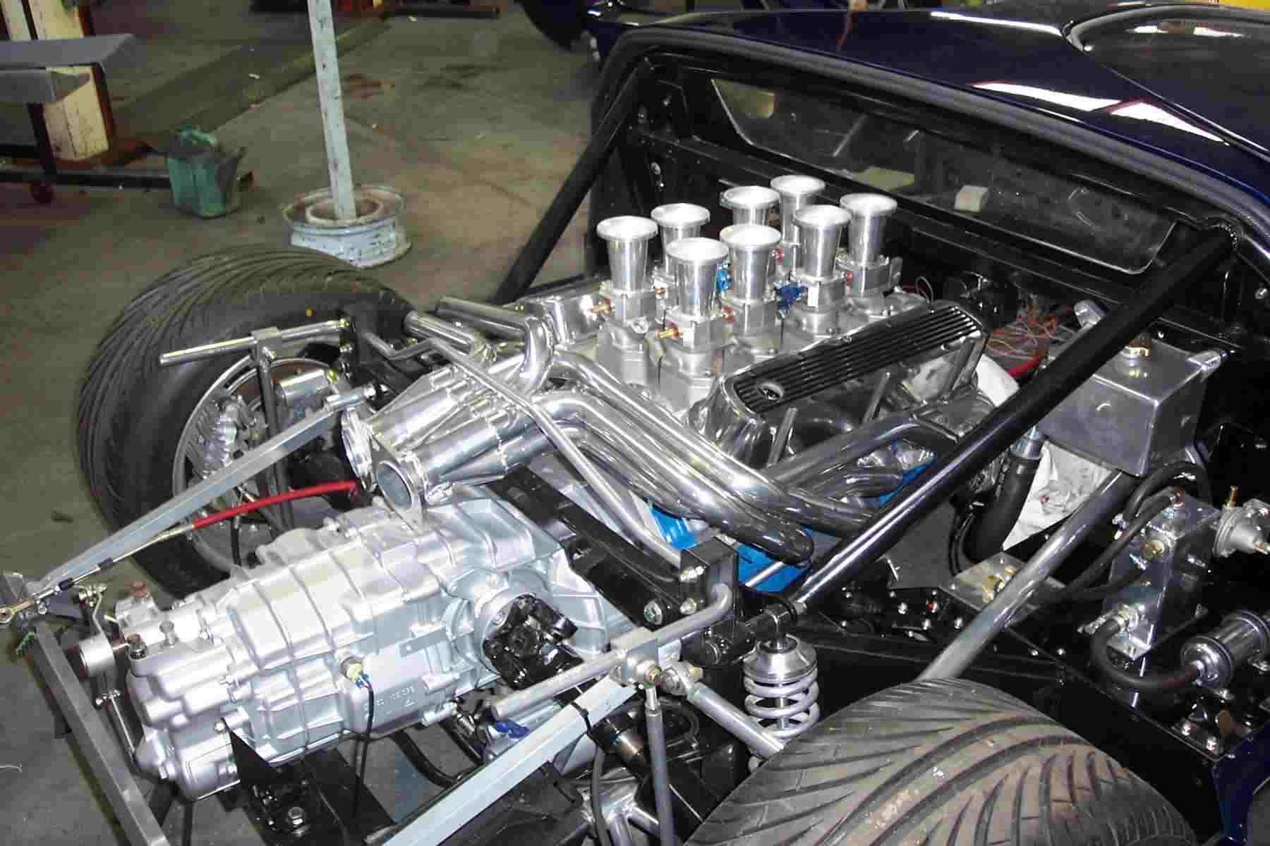

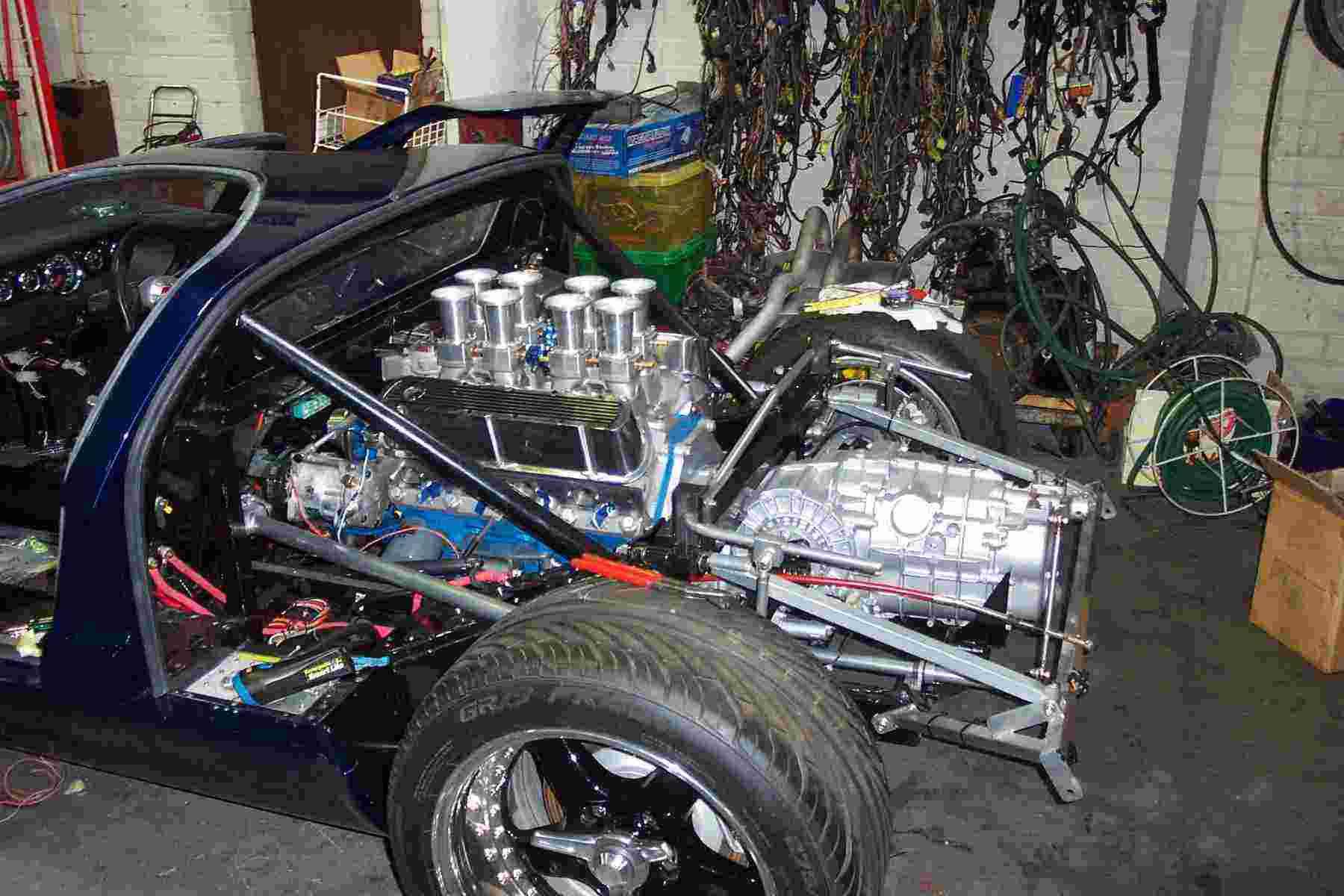

Now we are in the final stage of getting the engine set up. In order to meet the registration requirements, we need to meet some fairly stiff emissions tests here - so I engaged an expert in the field to help.
The stock '95 Mustang engine now has a new cam, AFR heads, a DC&O-based 8-stack setup, etc - all designed to meet the emissions tests (at least, that is the plan) ! To get better fuel delivery into the heads, we have reversed the throttle bodies so that the injectors are on the inside (like the TWM setup) - now that was a challenge to squeeze the fuel rails, injectors, linkages down the middle of the throttle bodies. We are nearly there, & the following pic shows the overall setup :

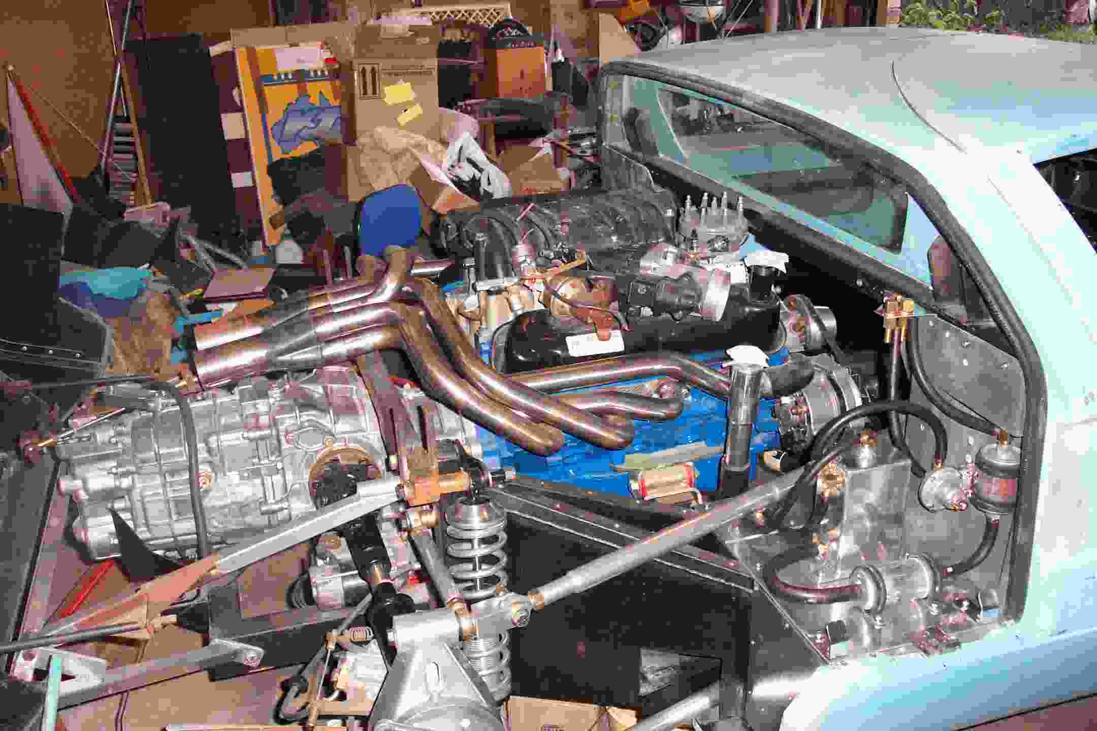

Throttle linkages & fuel rails are now made up & test fitted - should go on permanently in the next day or two.
Engine wiring harness is finished - all we are waiting for is the ECU.
Headers are ceramic coated & final-fitted (see pic).
I was going to run the standard Ford dizzy - however, with the injectors & fuel rails up the middle of the stacks, the front injector fouled the top of the dizzy. @*&%#@ !!
We therefore are running a cut-down Ford dizzy with dual trigger rings / sensors in the lower part of the body, 4 x dual coil packs & 4 x igniter modules. About $600 more expensive than the standard dizzy approach, but will give more accurate control of spark (and it fits !).
Another couple of days of bit & pieces, and we should see a start-up - man, have I been hanging out for that !!!
After basic tuning at the shop, we will put it on the dyno for final tweaking

The paint needs a cut-back with 2000grade & a buffing - if I'm not happy with this, it will get a final flow-coat of clear again. Once the paint has settled, I'll put white side stripes on, then think about centre stripes. Bill Bayard's car is a similar colour to mine (with side stripes) & he has done a mock-up for centre stripes - they really do look good, so I am leaning that way.

Thanks guys - the paint colour is Honda Marine Blue from the last Prelude series, made up in 2-pack by Spies Hecker with a little touch of pearl in it.
As to "skill" - there's not much of that around here. All it takes is patience, bloody-minded persistance & vast clouds of sanding dust! Anyone could take the body finishing process through to the primer stage - I think the secret is to add f/glass as required (I went through about 10m of chopped strand mat & 6 litres of resin), do a reasonable block-back with 80 grit, then coat the whole thing with a very generous layer of sprayable polyester resin/filler (eg. Spies Hecker's "Raderal"). This fills all pin-holes (hundreds of them appear if you just run primer over bare f/glass) & gives a uniform surface for the final block-back with 120 grit, then 400 grit. The final trick is to run a light "guide coat" of black over everything & block it back with 400 grit again - this shows up tiny imperfections which you just can not see in primer.
