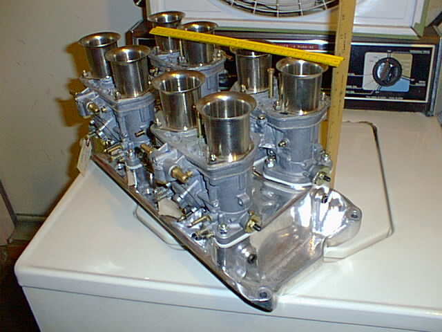

My car is not an RF (GTD) but I thought these photos might help out. I am replacing my Edelbrok Performer RPM and 650 Holley DP with the webbers. The measurments between the 2 setups is almost identical (no aircleaners on either setups).

Re: RF cars with Webers - Who\'s got em?

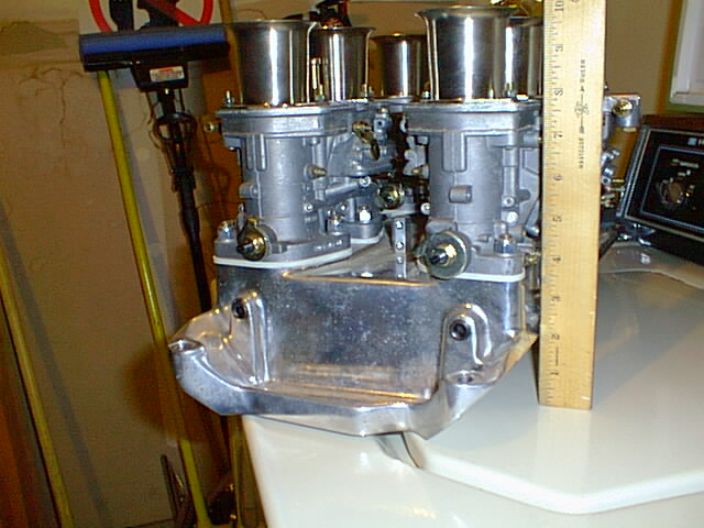

Here is the other angle.

Faili,
those from Pierce? Look exactly like mine!

Faili, that must be some parts washer you have there. That carb set-up looks fantastic! /ubbthreads/images/graemlins/wink.gif

Ron, your guess is right, they are from Pierce Manifolds. The carbs were jetted for my Ford Crate motor (345-370HP). I bought them 8 months ago, and now trying to put them on.
I have heard the same thing as Rick, basically IDF's are more streetable than IDAs. I have this bad feeling that I am gone miss my 650 Holley once I do this /ubbthreads/images/graemlins/confused.gif!! I hope NOT.
Fred, try Pierce Manifolds, they might be able to help you on Manifold selection.
Mark, if the washing machine gets nicked, I will have to sleep in the garage /ubbthreads/images/graemlins/grin.gif
