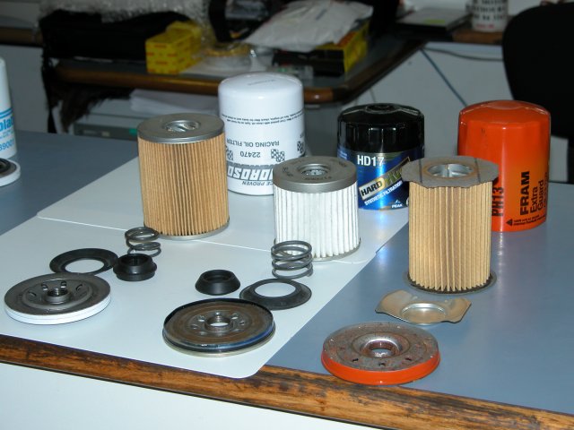

I suggest that anybody serious about their engine buy a few different filters then cut them open and inspect them. You don't need to be a technician to see how bad some filters are. While you're delving around inside, make sure you look at the bypass mechanism. Any bypassing filter will allow dirty oil through the engine but some actually wash the dirty side of the filter with the oil before letting it flow on through the engine... I kid you not.
If you get a non-bypassing filter just make sure it can flow enough oil for your engine and still filter it.
Filters sure ain't filters.
I won't name brands on a public forum but some of them should not be called filters at all, it's misleading.
Also, once you've looked inside it's surprising how "similar" some filters are to "other" brands. Perhaps "identical bar the paint job" might be a better description. In some cases it's a pretty expensive paint job as well.
See if you can find the brand with the "cardboard" internals.
Oh and be careful you don't cut yourself.

When I was a member of the Superformance Cobra's user group there was a similar article about oil filters. One of the guys cut a dozen or so oil filters open and examined their innards. Unfortunately, I can't reference the article here as once I sold my cobra I lost access to the web site. Fram was one of the ones found to be of dubious quality. One of the better filters turned out to be the Mobil One synthetic oil filter. Is anybody using synthetic oil in their engine?
Fram filters are not good, as they say, cut it open and see. FMS are fine so I'll stick with the FL-1A and I think I will use the dual remote mount. If anything it will add some oil to the system but before anyone uses a remote mount make sure the flanges etc. are of good quality. A couple of fellows on the Cobra board runied motors with cracked flanges and hooking the lines up wrong.

I took a photo' today of three of the filters that remain from the pre mortem that we performed. Two have been mentioned here, the other is one I like.
I have a lot to say about one of them but I think I'd better not.
I have been using Hard Driver filters for a while now.
There are also a couple of "competition only" non bypass filters available that are of very high quality. Unfortunately I don't have photo's of them.
Tim.

Thanks too for the filter info. I always wondered about these things and if they really are as good as they say. I'll try the HD-1.
