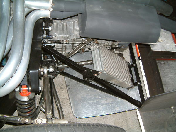

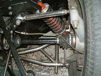

Howard, have a look at the pictures of Andrew Fordyces GTD which has had the Engine/gearbox lowered by 80mm, which involves cutting and reforming the rear chassis, widening it to allow the gearbox to lower between the rails, and repositioning the rear suspension. The lower rear A arms are shortented and the top mounts modified. Frank
Howard,
here are a few of pics of the mods I did to my car.
I moved the top link up, fabricated a new crossmember to hang the box from.
Removed the rear section of the chassis and fabricated an undertray and rear deck support frame.
The wishbones are scratch built, the uprights are GTD racing. Hope this helps.
