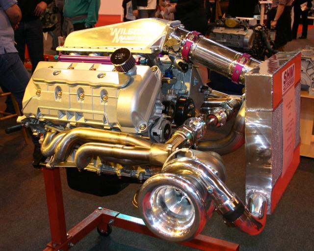

1) 4.6DOHC Ford - 1100hp@7500 & 1200ftlb@5300 - £35K / US$63K

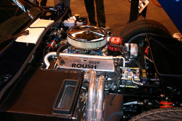

The Roush 402 makes just over 500 HP.
The big problem with fitting these engines to a GT40 would not be space; even the turbo engine could be replumed to fit. The question is: where do you get a transaxle that is designed for 800 to 1,000 ft. lbs. of torque?
