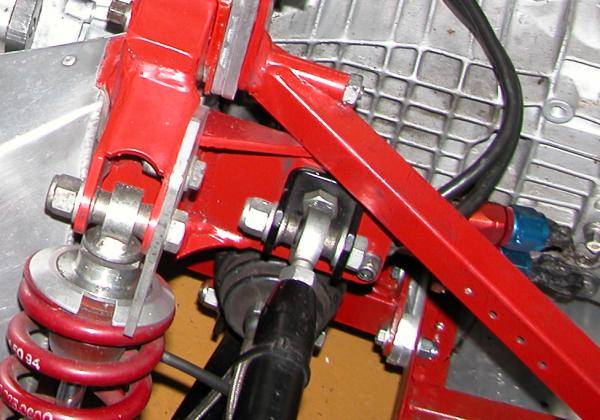

I am in the process of doing something along the lines of D Bell's recomendation as to relocating the rear upper links upward. I believe I will be using a rod end at the inboard attachment point. I have checked into different rodends and have come to the conclusion that any suspension parts that use rodends should use ones made of heat treated chrome moly.
They are not cheep but necssary. So here is the question, what size? I was thinking 1/2 or 5/8 inch. What are you guys using?
Hi Howard
On Roy Smart's GTD (and many others I believe), 0.5" - Regards Paul
Howard Jones
Thank you Paul, One of C Smith's books says that on cars up to 2500 pounds we should use 1/2 grade 8 bolts to attach suspensions parts. So this is where I came up with 1/2" rodends. I just wanted to confirm my thinking with you guys over in England that have developed cars.
