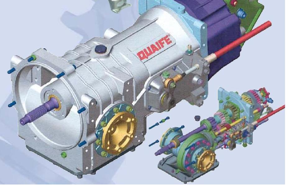

I notice that the Quaife has a bolt on, Porsche style
doughnut mount on the rear. If only Porsche would cast their
gearboxes this way, a 6spd might drop right into a GT40.
Smart engineering on Quaife's part. Wishful thinking on mine!
