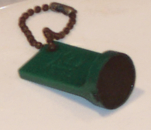

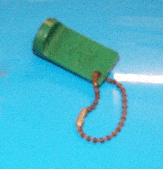

I can't get the locking wheel nuts off a car I've just bought. I've found the tool (the green thing in the pictures) but whatever I do with it, I cant get the wheel nut cover off. It rotates, I've tried tapping it in with a hammer but to no avail. Has anybody seen these before and how the hell do they work?

Sorry. Never seen anything like that before for wheel nuts. Looks like plastic. Can't be that durable? /ubbthreads/images/graemlins/confused.gif

The plastic part may just locate on a cover plate which conceals the hex nut underneath. We had something similar
on a 4x4 Sierra and once the cover (which effectively just pulls off) is removed the 'combination' socket is then useable on the locking wheel nut. If its corroded, some heat, some plus gas, some gentle persuasion, then out comes the cold chisel.......
Not sure if its the same but I saw something similar once that was magnetic in some way. You pressed it against the head of the wheelnut cover with one hand, whilst pulling the cover with the other. The cover then came off to reveal a wheelnut on which you could then fit a socket.
Never know - worth a try? /ubbthreads/images/graemlins/confused.gif

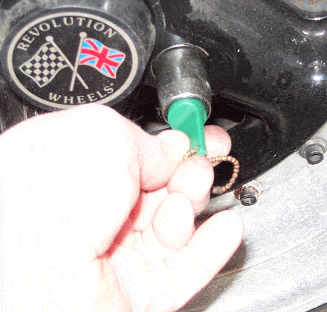

Hi Simon
I'm pretty sure that these locking nuts are standard Revolution accessories.
Check out the pesky little green keys on the following image:
I bought a set of wheels from Tyre Save, who stock the whole Revolution range. They should be able to help with a new key if needed.
Tyre Save Revolution page

Sussed it!
It's a turn and pull thing. One of them stuck fast so had to be "persuaded" with a hammer.
