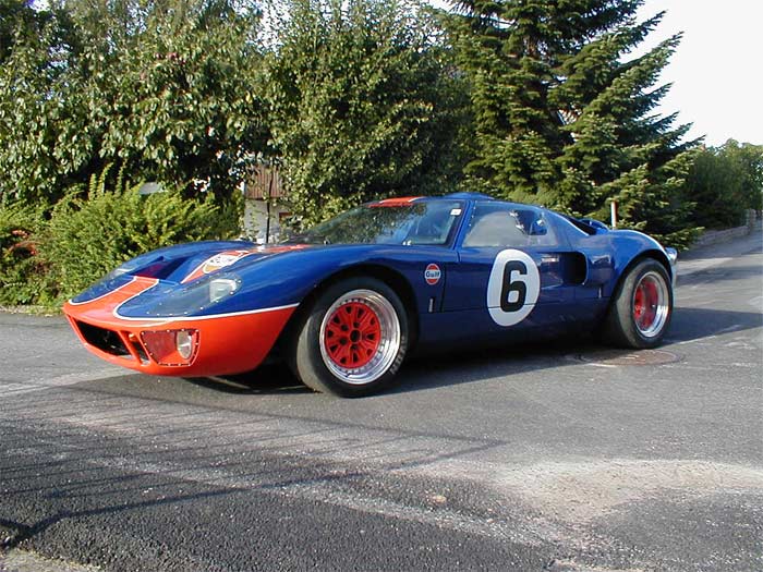

If the GT-40 you saw at Hooter's was blue and was near Kenasaw it was my CAV. You must have a lot of money if you want an ERA and want to waite for years to get your car. /ubbthreads/images/graemlins/cool.gif
OOPS, I sent the wrong colored car that you saw.
The #6 car that I sent first IS a BIG SHOW OFF!!! Joseph /ubbthreads/images/graemlins/grin.gif /ubbthreads/images/graemlins/grin.gif /ubbthreads/images/graemlins/grin.gif

WOW !! Is that NICE or what?
Absolutely beautiful. Thanks for the pics, this one your's Kalun_D?

"Absolutely beautiful. Thanks for the pics, this one your's Kalun_D?"
The small pic is from TWM's site. I purchased this set up for mine, think it's still on sale.
The large pic is off Roaring Forties site.
Chris Duncan
