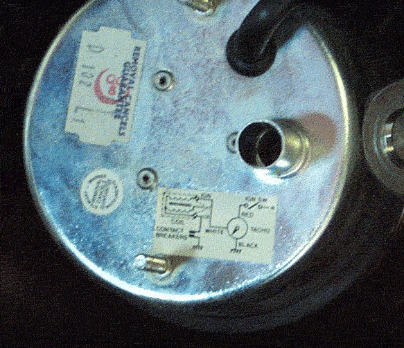

OK, heres a picture of the back of the tacho, which shows the white tacho wire going to the + side of the coil!!! Now I know I don't connect it to the coil, it goes in the tacho output of the MSD, but I just want to check this is ABSOLUTELY right. (not the coil/MSD end but the tacho end)
Howard Jones
Run the white wire to the spade conector on the end of the MSD box. Do not hook it (white wire) up to anything else or hook anything else to the spade connector on the MSD box. If it works then cool then your are done. If the tach does not work then you will need a MSD tach converter. You will not hurt either the tach or the MSD box by trying this.
If you want to, post a picture of the front of the tach I'll confirm that you have the same tach as mine. My tach worked first time without drama hooked up with white wire to spade connector on MSD box.
