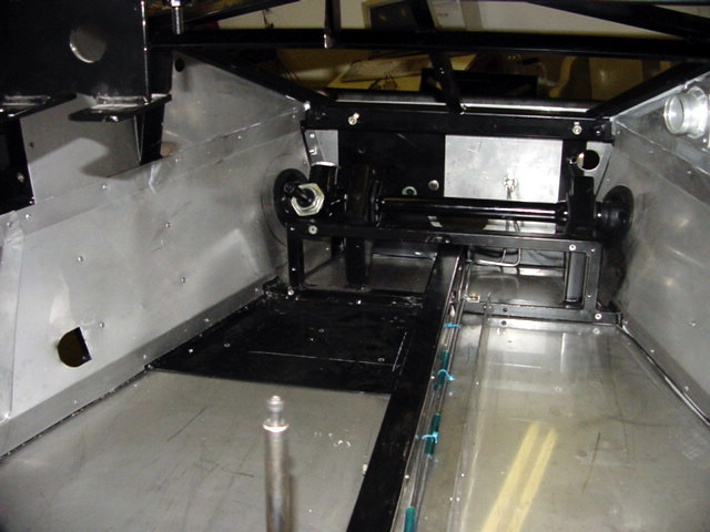

Here is a picture of my chassis in the paneling stage.
I used the satin finished stainless insted of the shiney stuff.

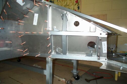

I also went for the SS option with a 2B finish and I am very happy with it.
