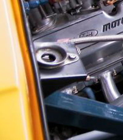

Thought I recognised the picture - car 010 aka - Robin Batt's 'Yellow Peril' from the GTD section of the GT40 Register on the club website.
Anyone wishing to include their car also - please mail me details - the more the merrier! (members or not!) /ubbthreads/images/graemlins/smile.gif

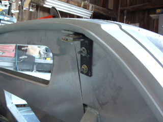

I just installed a set of early Mustang hold downs.

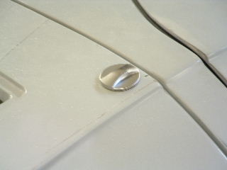

Hershal's look great countersunk into the body, just like they belonged there from the beginning.

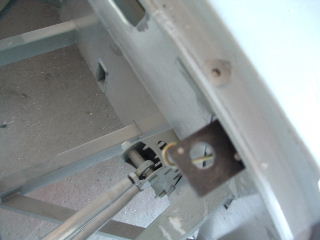

I remember this post where pins were pushed through fron the passenger compartment into the rear clip to ensure it was cloased. The positioning would not allow the door to be closed unless the pin was home (closed) position. The following is the post and picture.
To me this looks like the safest bet on any type of retainer.
