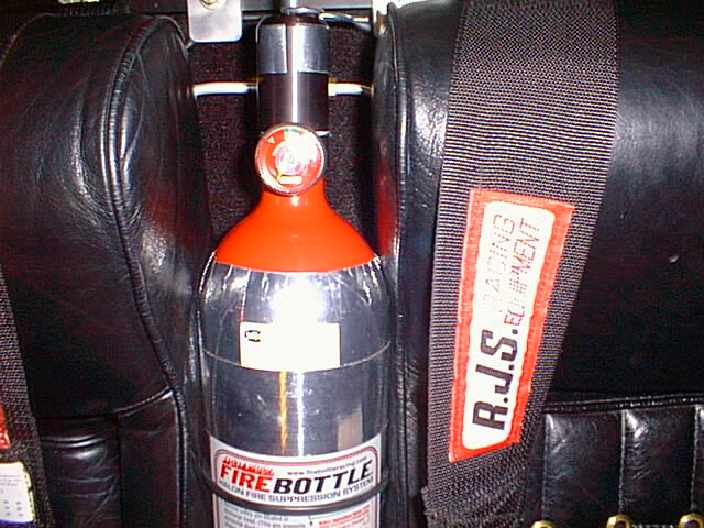

I bought a fire safety system from car shop2 weeks ago (see photos below, part number RC500). 5 lb Halon bottle with all the fittings, aluminum lines and 2 nozzles. Price was $285. I am sharing the info with all of you to compare and get the best deal.
Here is the shot of one of the nozzels.
and some of the fittings, there are more.

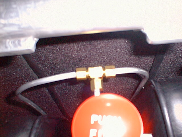

Lynn, My system uses CEA-614. This is the current replacement for Halon in newly installed fire systems. It is slightly more costly, aprox. 7%. What about the question about deplacement of air inside a closed cockpit? Here is what I think.
In the event of a fire that gets into the drivers compartment it is more than likely that the driver has already pulled the fire handle and started to get out of the car before he runs out of breath. This is a good thing because any product of combustion gasses or superheated air inside the car wouldn't be much good for breathing anyway.
If in fact the driver is trapped then cool halon that has no air in it will kill you as well as the above hot gasses/air. I think I would rather take my chances with the cooler option.
And, should the driver not be able to pull the fire handle.... Well on a track you have cornerworkers that will need a outside fire pull that is clearly marked. On the road....... Someone once said that when you are about to hit the wall pull the fire system. Ya right! Like I'm gonna remember that.
This is really one of those things that have no really good outcome except the fire system you install in the car will give you 5-10 sec or so to get the hell out of there.
Should you have a engine room fire it will of course save your car for you.
Put a fire system in your car reguardless of where you get it. 300-350 bucks is nothing compaired to standing on the side of the road and watching your car burn to the pavement.
My 5 pound system has one valve up under the dash pointed at the drivers chest and another in the engine room pointed at the top of the engine.
I hope I never use it.
