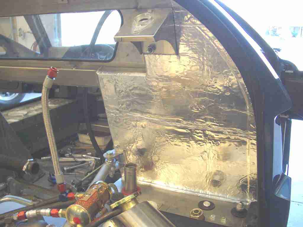

Hey Guys, Here is a picture of the sound insulation installed on the engine compartment side of the bulkhead behind the seats. I have a sample of the stuff and it looks like it should work realy good. Joe /ubbthreads/images/graemlins/laugh.gif /ubbthreads/images/graemlins/laugh.gif /ubbthreads/images/graemlins/laugh.gif
