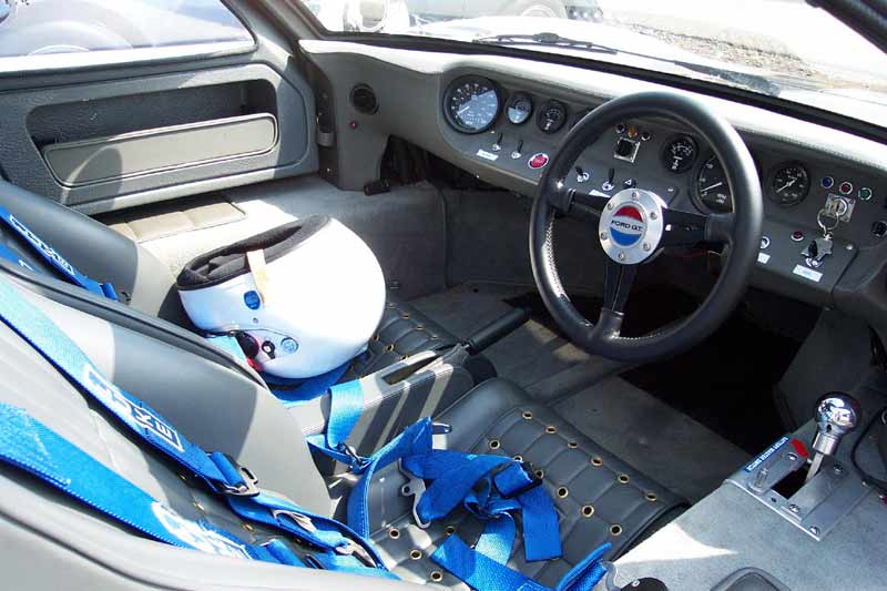

My GTD has the standard black interior. When I can afford it, I'd like to change the interior colour to grey and have the dash covered in grey leather. I saw a GTD with this interior last year (see pic) and was just wondering if any owners found problems with reflections? What paint is recommended for the interior fiberglass of the roof and doors?

Simon, My GTD has grey interior. I'd prefer black as the grey one reflects sunshine pretty much. I need sun glass whenever driving GTD under good weather.
You have two choices, and either will work. One is to paint the sil with a matte finish clear coat like this:
or do the usual clear coat and wet sand with 600 grit to obtain a flat finish.
