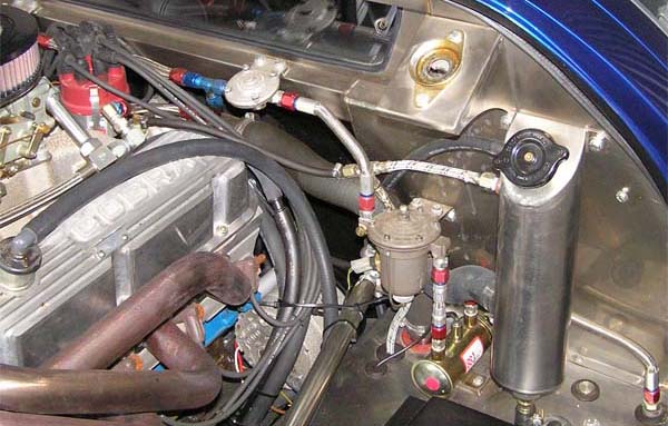

Hi Pat, Welcome to the Forum. My CAV #8 was a turn key minus. There was almost no fabrication needed. The 302 and getrag dropped in with only a bracket for the altinator needed to be made. The filler tank for the cooling system was moved up about 3" and a vent drain from the intake manifold was " T-eed " into the filler tank to let the air bleed off the top of the engine. This has worked very well. This was done back in December 2002 and I have had no heating problems even being stuck in traffic in 98 degrees. Here is a picture of how it was done on my 40. Joe /ubbthreads/images/graemlins/smile.gif

Thank you for the nice welcome, information, and even a picture!
