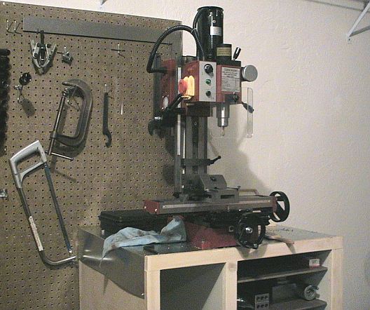

Make your own. That's what the milling machine is for. /ubbthreads/images/graemlins/smile.gif

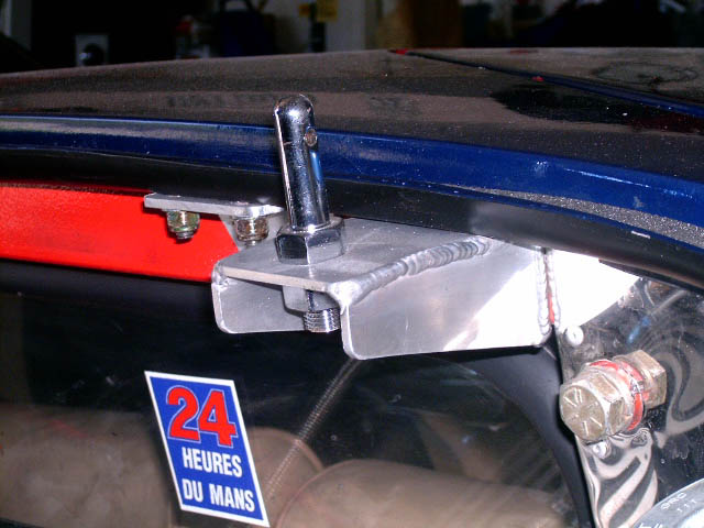

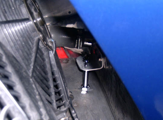

The CAV's have a pair of hood latches in the rear to provide a more secure hold-down than the side clips. You can see the engine compartment side of things here:
The release handle is made of plastic and has been known to break (or come off) /ubbthreads/images/graemlins/shocked.gif

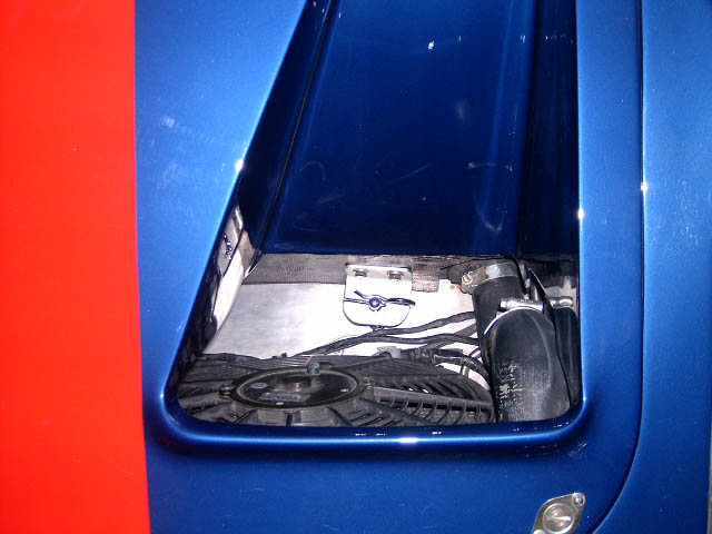

I liked the resulting piece of mine so much I did this to the front nostril cover.

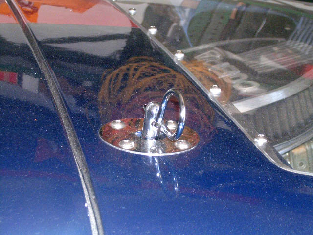

Frank, thanks for the links, really cool site! These Aerocatches look like the solution to the problem. They look like they were made for a GT 40. The size is perfect.The price is not bad either. I would spend more money in fuel chasing parts to make my own system. I saved the site for the US distributer for future use also!
