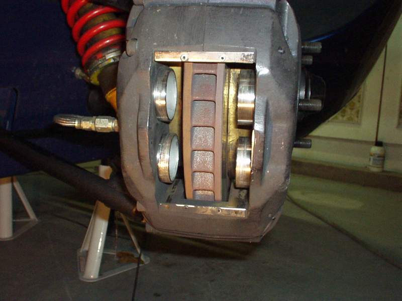

I am still not happy of the braking on my GTD (Wilwood 4 pots on front and single pot Scorpio rear). During the 2 laps at Le Mans Classic my pads smelt burnt odour at the first chicane in Mulsane straight, ok it was a big brake at 160 Mph but this should work correctly normally.
I spoke with Mark Sibley (MDA GT40) who explained me that the original GTD spindles & front uprights are not stiff enough and allow the calipper to move from the disc with a consequence of a bias wear of the pad, i verified and my pads are effectively bias weared /ubbthreads/images/graemlins/frown.gif

If you are gettind wedge shaped pad wear then check your brake calliper mounts are mounted equally around the disc ie they are not at an angle before you even start to use the brakes. I made my own bracketry and found that I had to be really carefull in the alignment of the calliper to the disc.

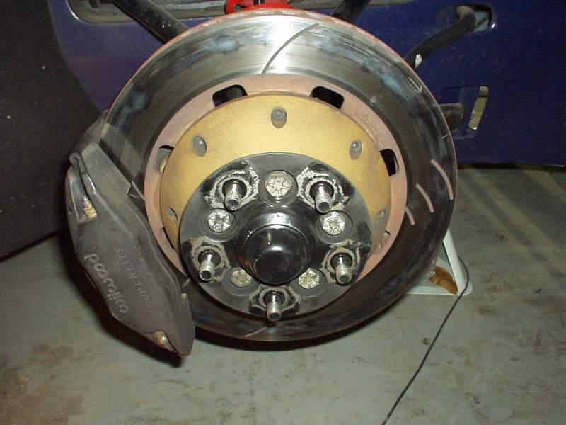

But the uneven pad wear on the front will remain an enigma ...take a look to the disc surface, strange wear isn't it ?

The wear marks on your rotor suggest that the rotor is slightly thicker at the outer dia or that it is warped a little. Did you mic the rotor to check that it is the same thickness at the major and minor dia's of the brake swept area of the rotor. If it is warped or tapered a clean up cut on a lathe should fix your problem. My setup is very similar to yours (except that I have 13" rotors front and rear), and with heavy use of the brakes I experience very little fade even when they get almost red hot.

Hard to tell from a photo, but it looks like hard spots in the rotor casting. This is not uncommon with some cast irons. Typically the hard spots look more shiny than other parts. The hard spots generate a lot of heat compared to the rest of the surface and from the photo it appears that this is the case. Hard spots are best removed by grinding the rotor rather than machined in a lathe.

The marks on the rotor look like hot spots to me. But as you run single pot solid disc rear brakes your fronts will be heavily overworked. GTD dropped the use of solid rear discs after a while and only sold vented rears. My car originally had the solid rear discs and they eat up pads with little braking effect. My record was set of pads gone in 80 miles in one day at Goodwood, lots of brake dust!
From seeing your front brakes my suggestion is to change your rear brakes to either more Wilwoods to match the front or just to the vented single pot caliper set up typically found on GTD's. Your existing caliper will not be alterable to suit a vented disc, discard it! However it is not just a matter of changing calipers and discs over, you also need to mod your rear upright so that the new position of the caliper is better for brake bleeding etc. The steel uprights you need are available from Roy Smart I beleive.

Fred, I think that roaldin has touched on a likely issue here. From the strange pad wear, and the picture of your disc, it is possible that you have to much flexibility somewhere in the caliper mounting. This could be in any adaptor component used to mate the caliper to the upright, or in the caliper mounting on the upright itself.
From what I understand, too much flexibility in this area has two effects, first, deflection and twisting of the caliper relaative to the disc under steady braking loads, which causes the biased pad wear, and second, brake judder which causes the hotspots on the disc.
I would look carefully at the caliper mounting for any flexibility due to insufficient robustness, or poor mounting due to any additional spacing washers used to position the caliper.
I have seen some brake upgrade kits which look very suspect in this area.
So, did you notice any judder while braking hard? because those heat markings certainly suggest it.
What is the pattern on the inside face of your disc?
Does the caliper use a mounting adapter and any spacing washers?

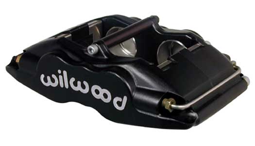

Interesting, the calipers are the same as mine - an early willwood superlight. I assume you do not have bridge bolts across the caliper which will allow an amazing amount of flex and uneven pad wear along with a long pedal. I had this trouble and fitted the bolts both front & rear. this made a huge difference to braking ability, pad wear & pedal travel.

Dave, Rick,
Your comments are very interesting, the callipers are fitted with a kind of anodized bracket on the upright.
Rick i had some troubles to understand exactly what you ment (don't forget i am French !!!) Which bolts do you spoke about ? A pic would be welcome to understand ...

I am using superlight front and dynalight rear calipers. Both are 4 spot calipers. You will find that the earlier versions of these calipers had the pads held in place with split / cotter pins.
If you have a look at the wilwood website you will note the current superlights have bridge bolts fitted which prevent separation of the caliper halves which causes the tapered pad wear and long spongy feel at the pedal. You should find that the superlights already have 1/4" holes already drilled for these bolts to be fitted. These are located on the side that the pads are inserted from and either side of the cotterpin.
On the dynalight (rear) calipers the hole in the caliper halves for the pad retaining split pin was drilled out to 1/4". You will also need to drill out the cotterpin hole in the pads to an oversize 1/4" to allow the pads to slide properly.
Make sure you use very high tesile bolts and also a compression tube between the caliper halves so that the bolts can be torqued correctly without closing the caliper halves.

Rick,
I understand what you mean by bridge bolted, it is a good lead to follow. I am not sure to be able to use my old pads with a such modification but it is worth trying ...

If your pads are tapered throw them away and get replacements. I am waiting on delivery of some hawke "HP plus" pads. These are supposed to be very good agressive pads suitable for the street (ie no heating required) and be able to be used in relative anger for track days etc.
The picture of the wilwood caliper is exactly what I was trying to explain.
