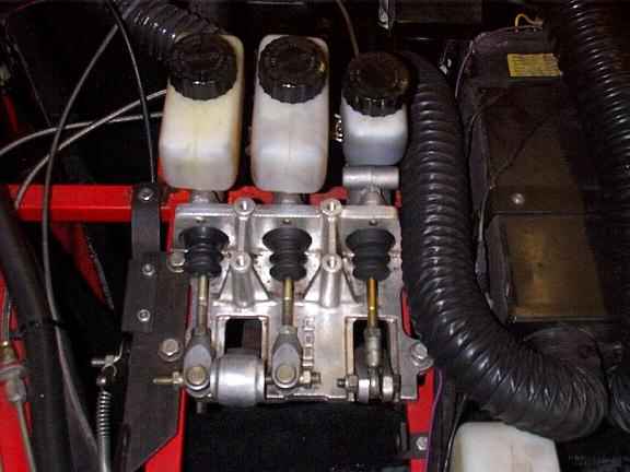

Howard, this is the only pic I have so far.
Simon, thanks for that, I'll look into that. You back on the road now?

Howard Jones
Thanks for the picture. It looks like the brake fluid tanks are in the drivers compartment up under the dash. Am I correct on that? I wonder if I would have room to do it that way. I'll have to check when I get my car back from the shop.
