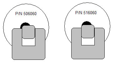

I had heard rumors that Jesel had once sold their Sportsman Series shaft mount rockers, part number KSS 506060 to go on AFR heads and then switched to part number KSS 516060. I recently bought an unused set of rockers advertised as KSS 516060; however, when it arrived, I noticed that the side of the Jesel box said KSS 506060. When I contacted the sellar he was very apologetic and immediately offered me a refund. He had purchased the rockers for his AFR heads and then decided to scale back and race in the pure street class. When he advertised the rockers, rather than going to his shop to get the part numbers, he just looked it up on Jesel's website and put the current number in his ad not knowing there had been a change to the number in the interim.
Now, when I mounted the open 1/2 of the rocker system set on one of my heads, I immediately noticed that the intake rockers were slightly off line towards the front of the engine. I moved them within the tiny bit of play in the system, but never could get everything to line up to my satisfaction. So, I emailed Jesel. The tech guy there said that, "We were selling P/N KSS-506060 for AFR heads , but that is before we got a head and realized it took a slightly different set up." When I asked him if any effort had been made to correct the issue for those who had already purchased ill fitting rocker systems, "I do not believe there was Lynn" was his response. The only thing he said in terms of getting properly fitting rockers was, "KSS-516060 is $695 if you have to purchase it through us."

I mocked up a head tonight with the rockers. I was mainly looking at how the intake roller lined up with the valve tip. It is much better than the KSS 5060606 rockers, but, amazingly it isn't as balls on centered as I thought it would be or as the exhaust valve is. I don't think there is going to be any issue with running them, I just thought they would line up better. It could be the way the valve springs are set too. The stock AFR spring set up is actually pretty crappy and, as I have mentioned else where, the valve springs have way to much freedom of motion. So, things might line up better when I get the good springs, locators, proper retainers, etc on them. I really hope I don't have to reface the angle cuts on the valves and then reseat them. That would be an expense I hadn't counted on.

Actually the Jesel kit comes with an adjustable pushrod length checker and very complete instructions for getting the proper pushrods. They obviously push you towards theirs, and there are a lot worse ways to go, but the basic information is universal and accurate. If you happen upon the article you mention or know exactly where it is, sure go ahead and send it to me. One can never know enough!
As far as setting the geometery of the rockers, I will probably just shoot for a compromise: Jesel says the plane through the center of the rocker axle and tip axle should reach 90º to the valve stem at ~.75 lift. This puts the max mechanical advantage in the area of valve lift where spring pressures are the greatest. The mid-lift theorists basically ignore this aspect and only focus on efficiency of motion, or fidelity of the transference of the cam lobe profile to the valve tip, and try to reach the orthogonal point at .5 lift. So, if I can get the 90º position any where in between .5 - .75 lift without having to machine the stands or the set of shims that came in the kit, I'll be a happy camper.
