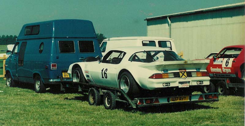

Phil, I just wonder how it now handles on the straight? I had a similar problem with the Penske Camaro and when I reduced castor to aid turn in, it worked a treat but became a handful on the straight especially on bumpy tracks where it tended to follow every line and groove in the asphalt. Found I couldn't roll a fag on the Hangar straight at Silverstone any more, and I missed my nap as well. Bugger! /ubbthreads/images/graemlins/crazy.gif
PS Penske IROC Camaro "resting" at Goodwood together with Trans Am.

Ken oh sorry Keith (only joking)straight line stability is
fine on my car.Maybe you took the castor back too far on the Camaro."Most racing cars are designed with between 2.5 and 4.5 degrees of positive castor" Carroll Smith (prepare to win)Mine is set to 4.5 degrees.
Ross
Russ, (stop it /ubbthreads/images/graemlins/mad.gif ) You may be right, I believe the castor came in at a shade over 2 1/2 degrees, but before, it was well over 5!! (previous owner who sold it to me cheap said "it wouldn't go around corners") heh heh. /ubbthreads/images/graemlins/wink.gif
